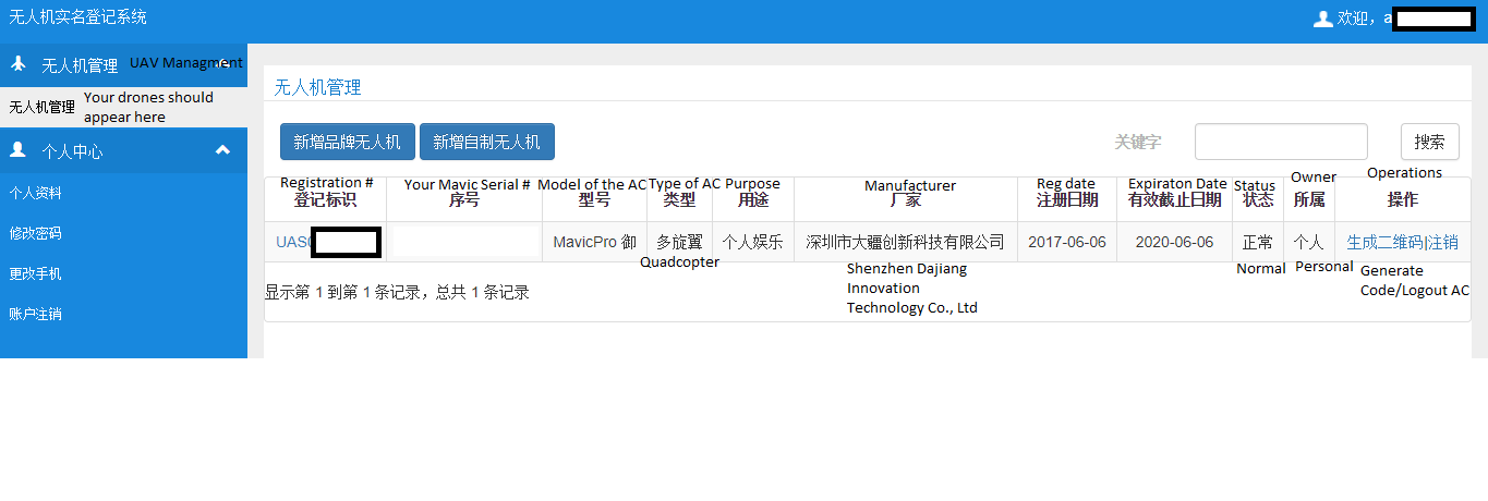

Hey thanks for your PM.
Sure I can help you out, in order to register in China you must go to the following website: https://uas.caac.gov.cn/login
The site is in Chinese and I recommend you use the tool from Chrome to translate the page directly in english.
Please have a look at the picture bellow, for better understanding.
- For your registration number look at the picture bellow.
- I had translated the Chinese name of DJI also, in the picture bellow.
- Once you select the manufacturer and model the system already has the data of the weight of your drone.
- The Mavic is a Multi rotor type.
Once you had successfully registered, press on generate two dimensional code and wait a couple of seconds. It will allow you to download a pdf file with your registration number and QR code which you must print and stick to your drone. I recommend you put it inside the battery bay, it will be protected and as the regulations says most be in a easy accessible place in which no tools are required to have a complete access to it.

Sorry, I misread your first question.
The Drone serial is in your battery bay.
And yes you will have to register your phone number into the DJI App even after registering to CAAC. They are 2 different things.
