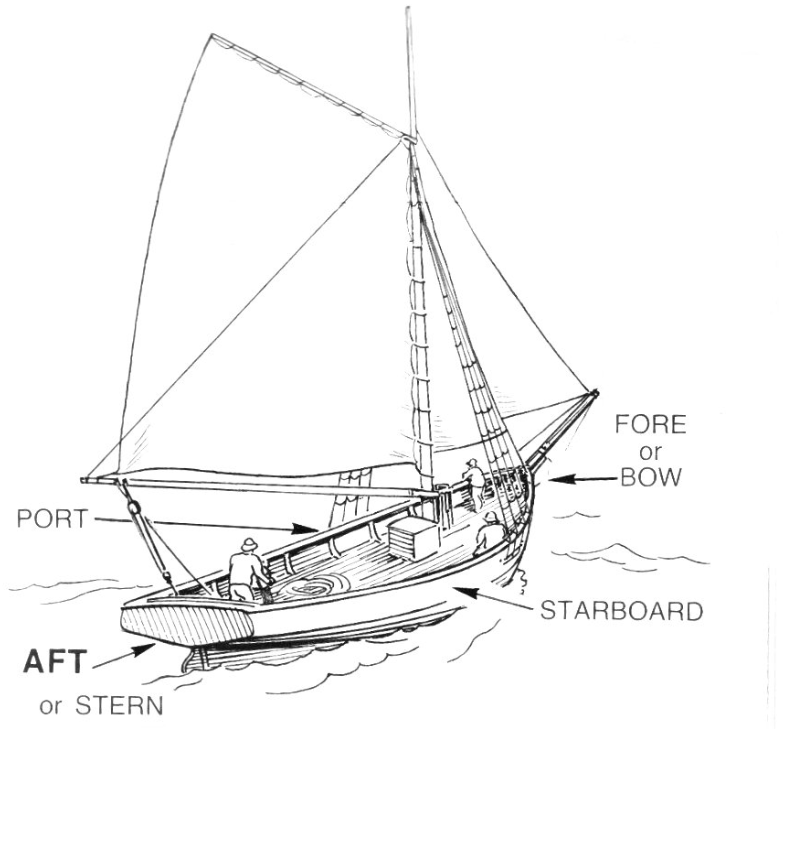

Hey there, so just to be clear. Top right? Are we looking down on the drone from the back or from the rear?
