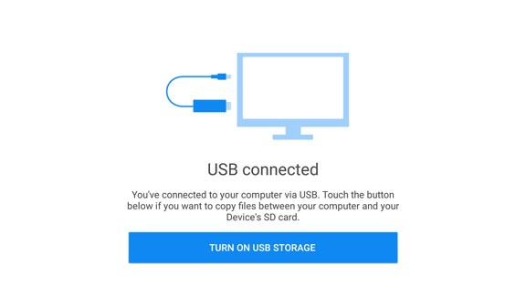

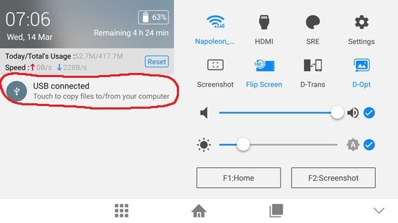

when you connect the CS either via the micro usb on the side or the usb-c on the bottom, you'll hear the pc connect with some  "dings"
You'll see in the photo below that a message will come up on the notification side of the settings screen, you need to tap on this message.
A second screen will pop up with " turn on USB storage" button in blue, tap on this and a "DJI" drive  e.g E: should be created in you PC file explorer , this will then show the internal CS storage.
You'll also see another removable drive in the PC file explorer and this will have a different drive name e.g G:, this is your SD cards have you have installed on the CS

Thank you Iannes, after getting back I read this post and managed to get that screen on the CS monitor and connect to my PC by using "turn on USB storage" and the CS showing in file explorer as DJI (E) drive, opened this and can find a pictures folder but only four photos in there, panoramas but what should be spherical ones aren't, just distorted  long photos. In DJI (E) drive I have now opened DJI GO V4 cache image folder and found more photos there but no sphere panos but I will investigate further. Now have to leave for an appointment in another town but only 30 Kms away. Thank you for your interest.
