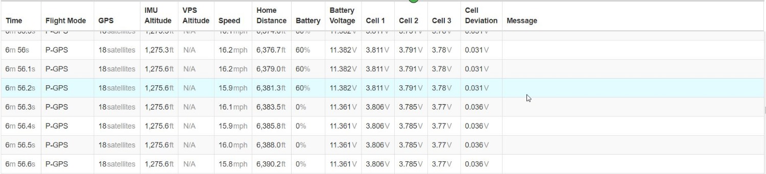

Got my Mavic Air "fly more combo", charged batteries and went for a test flight (all batteries was fully charged less than 24 hours prior flight). When flying one of batteries charge suddenly dropped from >60% to 0%, drone starts to land with "battery critical low" warning. I was able to land safely, so no damage to drone was made. After landing, battery indicators shows one blinking led and dji GO 4 app shows 0% battery charge and voltage also at 0 (which is very strange), but drone was still powered. When I started to recharge this battery, in a minute or so it went from one blinking LED to three. When flying with remaining two batteries after this accident, everything went OK. So, taking into account all data, I assume one of batteries I got is defective. Any suggestions and opinions ?

Nerius, thank you for the info. In your case, if it is possible, please provide us with the flight data from the drone, you can export the data via the DJI Assistant 2, upload to Dropbox and paste the link here, we will forward the data to the engineers to confirm again. Thank you in advance.
Thank you very much.
Attached please find dropbox link to all logs found in drone using dji Asistant2:
https://www.dropbox.com/s/zvxfbm ... 2_10-15-20.DAT?dl=0
Best regards
Nerius

Now I can confirm the circuit board inside the battery is defective. It shows 0% as it couldn't find any information about the actual percentage of the battery. Which is a rare issue. Glad you got a replacement.

Sent completely new defective Mavic Air battery (1 charge cycle) for replacement. Got back used (or refurbished). Although charging count was zero, package was not new, battery was fully charged and I can see dust, marks and scratches on plastic surface. Suppose dji technicians reset usage count.
I can understand, replacement used battery with another used, but replacing completely new with used which maybe counts a lot of charge cycles is not the best thing from dji side. This is why people (myself included) don’t want to send items back to dji and using it only as last resort. I suppose, you can send completely new, with a few flights, still under warranty and because of warranty issues,  drone to dji, but receive back another refurbished, with hundreds of flying hours. Unacceptable in my opinion.
I would not accept a secondhand product if my brand new one is defective. Send it back, demand a new one.

The Mavic Air battery issues continue.  My two day old MA (on it's sixth flight) (still on first charge of the three batteries in a fly more combo) was hovering with 56% battery life when the app screen went blank (no video feed) but could still see other non-video info from the app.
RTH started then the MA dropped out of the sky, breaking the front leg off and the rear foot.  Upon inspection I pressed the battery button, zero lights.
Removed that battery and put a new one in to see the extent of electronic damage.  With a new battery installed the MA powered on, props and gimbal did their initial start up movements and lights are on to all four wings.
Clearly a battery issue!
This was my first drone so I had all app failsafe  features enabled.  Flight log shows me hovering and 56% battery, then log ends.

The exact same thing happened to me the other day... I was flying my Mavic air and battery started at 100% I took it out about a km away from me out in the country. All the sudden I noticed my return to home icon was rapidly moving and I saw that my battery was rapidly draining like 1% a second !!! I tried to quickly come home but I wasn’t going to make it. Luckily I was able to land in a field safely not too far from me and was able to retrieve my drone. When I got to the drone it was still powered on even though when I emergency landed the battery was at 0% .... was pretty scary.  I have marked that Battery so I know which one it was. I recharged it fully and did a second test on it and it seemed ok. But now I’m scared to use any battery on my drone as I don’t want the same thing to happen again and not be so lucky the second time

Contact support, they will replace it. After they replaced my Mavic Air battery, everything is OK now.
