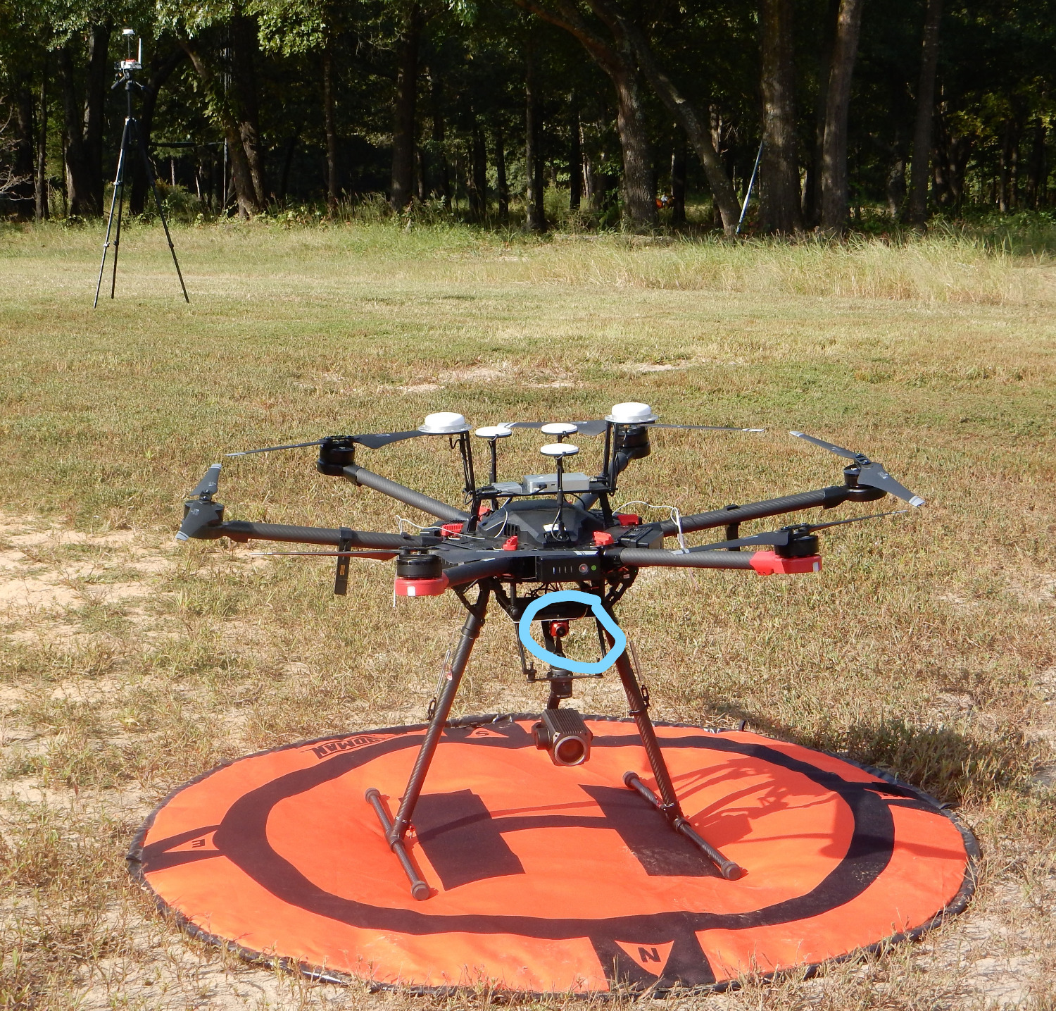

Need help on putting a FPV camera on my 600 Pro and running it as the main camera. So on the DJI GO App it will appear just like any other camera I might want to use. Does DJI make one that is plug and play?  THank you.

Hello, I have mounted a RunCam on each of my M600 Pros. I use the A/V input on the LB2. When using DJIGo app, the camera you would select would be LB, your other camera (Z30, Z3, etc.) would continue to be the Ext menu choice. I have been able to use the PIP feature, you can also put flight information on the FPV display (HUD). I have attached a photo of my install.

That is exactly what I want to do.....thank you so much! What model is your RunCam?

They are Eagle2's, I had them from when I was building drones as a hobby, they work great. Good luck.

Hiya...did you need a custom cable or connector to connect into LB?

No, there's an AVI connector on the LB.

When I read the instructions on this other website it says I might be to make my own cable I don't know how to and once u connect the eagle 2 cam can u see it in the dji app I really need help as son as possible thanks

The connector into the LB analog video input is a 3-pin JST connector. You can make your own cable or buy a pre-made cable, I think B&H sells a cable kit that contains a cable that will work.
The other end of the cable connects to the analog video output and ground of your analog camera. You'll also need to supply power to your camera which you can get from the LB connector or some other source.
