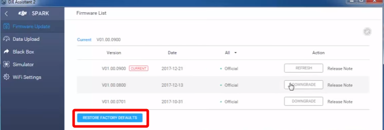

Hi, we're sorry for the inconvenience caused. Could you please try to perform restore factory default via DJI Assistant 2? Kindly connect your Aircraft to your PC and open DJI Assistant 2 and click restore factory default. After that, please update the firmware to the latest version. For reference, please see the attached image below. If the problem remains, I would recommend you contact our support and start a case. You may email us at support@dji.com. Thank you.
