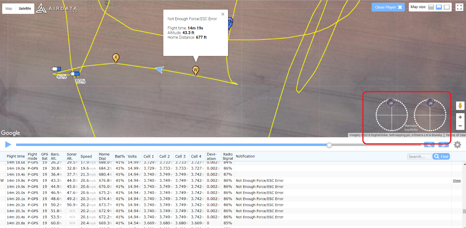

Hey folks, i didnt even notice this error on the day it occurred, never seen it before either, any thoughts please?

No recent crash, i did ditch it at the beginning of the year, many flights since,  i its the latest firmware for the P4P, its not done on 5 flights since nor has it done it on previous flights, i had a quick random check on previous flights, as you can see from the image below, at the time of the warnings i was using both sticks at full power, a steep and fast climb.
I have spoken to support and then want the ac sent in BUT, as it was ditched many flights ago, there will be nothing they will do and it will be a waste of time.....
