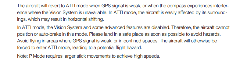

Hi, Sorry for the troubles that it caused. Normally, this ATTI mode will occur if ever the GPS signal is not enough or the compass might be interrupted due to the environment. I would recommend flying your aircraft in an open area and avoid a hazardous environment to prevent an incident. Please see the image below for reference.
