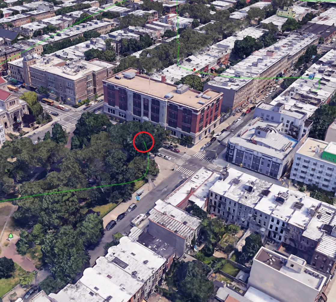

msinger
Captain
Flight distance : 214026 ft
United States
Offline
@Donjuan., what @DJI Diana described in this post is accurate (according to your flight log). You had full control of your Spark and flew it into these trees:
Here are some other things I found in your flight log:
1) Your Spark did not attempt to return home at any point
2) You did not manually initiate RTH
3) The battery was never low enough to auto trigger RTH due to a low battery
4) The remote controller was connected to your Spark the entire time and obeying all of your commands
5) 22 seconds before the crash, you stopped to take a photo here:
6) It was pretty dark out, so you probably had a hard time seeing your Spark. Here's one of your photos:
2018-10-25

Donjuan.
lvl.4
Flight distance : 2078228 ft
United States
Offline
msinger Posted at 2018-10-25 03:58
[view_image]
Thanks.i already had sayed that what came up in my live screen did not came up on this record.after taking the last pic signal was lost and it read returning home and the beep came up on the screen wich whent blank completly blank while still beeping as a sign that it was rwturning home.my faughter was with me as always watching an saw it too but thats my question why it did not showed on the sreen.as you can see i was close enough to see it.and i never touched the sticks as it was suposed to be returning home.i already had mention this over and over on my previous post.but i guess you have to go by what you see even if its not what i saw. This is crazy but it happened as i told.also i mentioned that its set at 30% low battery warning rth was not activated by it but for lost signal and even so i always get a low battery warning at 30% no matter what and if is far away it will give me 10 seconds to return home or it do it on its own.the low battery warning came up on the sreen rigjt before the last pic was taking but thats not on this record neither.it always give me a warning for low battery at 30% no matter what cause its the way i have it set up from day 1. Anyways thanks for helping so much and the time you took to do this stuff. I guess there is no way for me to proove the real thing that happened.i just hope this wont happen to no one else.im heart broken over this but its what it is,my lost. They can just keep it im not going thoug this again.very bad experience...
2018-10-25
