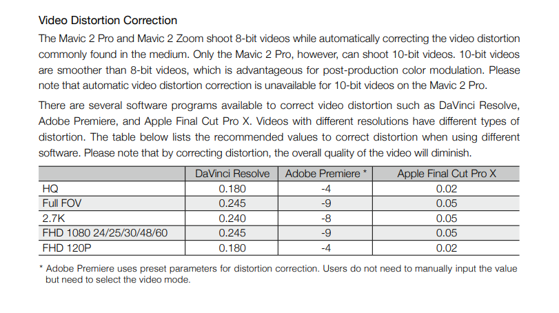

I'm experiencing some edge distortion on video that have a horizon line.  The edges of the frame are not straight and are curved.  I know this is a lens issue but my question is, is there a plugin for final cut pro that will correct this?  If so can you share a link where I can find it?

Hi there, thank you for reaching out and we're sorry to hear about the trouble. With regards to that concern If you having an issue with regards to video distortion when using DLOG-M and HLG color modes you can use this setting when post-processing the video
