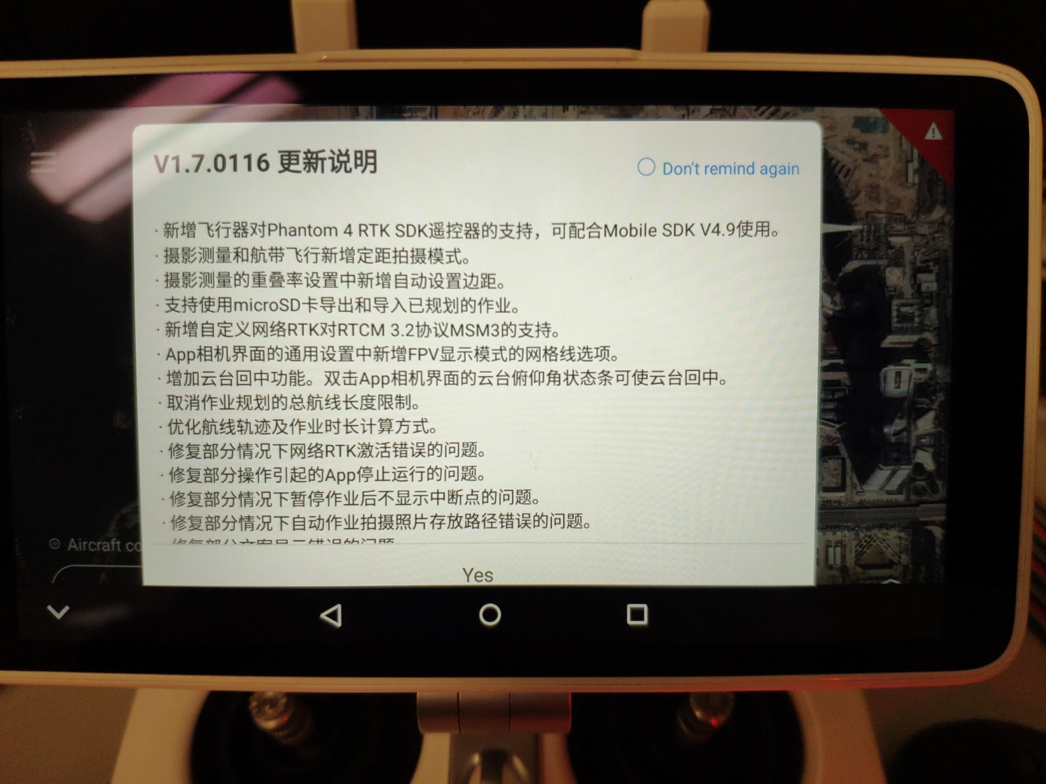

In the release note, it says that Phantom 4 RTK SDK Remote is supported and it can work with Mobile SDK 4.9.
I just tested and it does not work

Attached is the release notes:

RexHK Posted at 2-8 03:46
I upgraded the latest firmware 1.7.0116 for the drone.
Hi Rex, the firmware v01.07.0116 added support for the remote controller without a built-in display for use with Mobile SDK apps, but the remote controller that supports Mobile SDK still hasn't been released, our engineers are still working on it, we sincerely apologize for the inconvenience caused.
