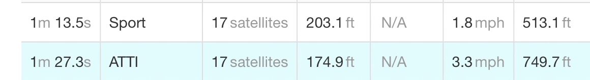

In the beginning of the flight you received the messege about restricted   zone (class D). During the first minute of the flight you had one disconnection at 0.53 and then at 1.27 you had this
2019-2-10
Use props
Lysak2003
Captain
Flight distance : 500052 ft
Ukraine
Offline
Log says that in that point the drone caught strong magnetic interference. It changed direction, as I suppose, with the wind. It droped an altitude from 202 to 174 ft and gained speed. Next it flew without any response to you actions and droped an altitude to 166 ft during 6 seconds. When connectoin was lost it was in ATTI mode, so couldn’t do Return to Home. So it continued to drift in previous direction and was dropping an altitude. I think, it stuck in the tree branch.

It says you took off in Sport mode. It can provide some malfunctions in drone work. You should take off only in P-GPS mode with necessery amount of satellites.

Maybe not.... At the end it seemed to be rising again.... And it has 91% battery left..... I could be very far from the estimated area.

Exactly.....Its last known GPS location is what find my drone gives you.
Yours was in Atti mode therefore no GPS connection & 91% battery left to keep moving.

Hi,
Had a look at your flight too, and read all the postings.
When a DJI drone in ATTI looses connection to the RC it starts an autolanding after few seconds.
So with 91% batterry power it will not fly for 'hours'....
In ATTI with no RC input your SPARK will flow with the wind and keeps its altitude.
Last records with no input Spark was at a steady height of 166 feet, drifting heading 105, speed approx 24 ft/second.
My guess you will find Spark in somewhere in the line last point > orange marking, but closer to the orange marking if it did not hit any obstacle on the way down. Autolanding in ATTI with wind is not descending at one spot but drifting on the wind while landing (closer to the ground often less drift)
