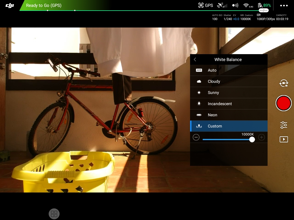

Dji please check this out i think the programing in your software regarding color temp is in reverse ,the closer you go to 32k it should get warmer not colder 56k is white light, here are sceen shots Screenshot_20190210-141604.jpg Screenshot_20190210-141613.jpg Screenshot_20190210-141625.jpg

Hello and good day Proteous. Thank you for the inquiry. Upon checking the color temperature of the DJI Spark. The closer you go to 32k it should go colder not hotter compared to 56k in white light. For reference I will be posting a link where in you can see the white balance settings. Thank you.

Whoa that may correct scientifically a digital cameras White Balance the lower the number the colder the image!!! hands down has been that way since the the start of photography!! SO PLEASE DONT SPREAD FALSE INFORMATION
laymans terms
your image is to blue looking? raise the White Balance....
your image is to warm looking (yellow, ornage color)? Turn the White Balance down
i really can't believe this sh*t....

I dont mean to be rude but the above statement is equal to the involuntarily emissions emanating from the back of my horse
White balance is a setting on your camera which is used to control how colors are captured in different types of light. ... Color temperatures range from cool (blue tint) to warm (orange tint). Using the right white balance setting will eliminate unwanted color casts that can ruin your image and make it appear unnatural

Hi Proteus,
I'm not a photographic pro, so please take this with a grain of salt.
I think you are mixing the colour temperature of a light source with the colour temperature setting of a camera.
In your 2nd picture you set the Sparks camera to 2800K. But the light came from outside, bright daylight. The sun gives us very high colour temperatures, that's why the picture looks  blueish.
So you need to /raise/ the camera setting to get natural colours.
One needs to set the camera temperature setting to match the light source on order to give neutral colours.

Hi Wolfer
I appreciate your input on this ,if im right or wrong is something that i guess will be decided by dji experts i just thought it strange that the control is backward

Proteous, you mixed directions. Daylight is colder (blue ish) regarding 3200K standard wolfram bulb from last century, so photos that you have posted are correct.
Just to say I work with cameras in studio on national television.
