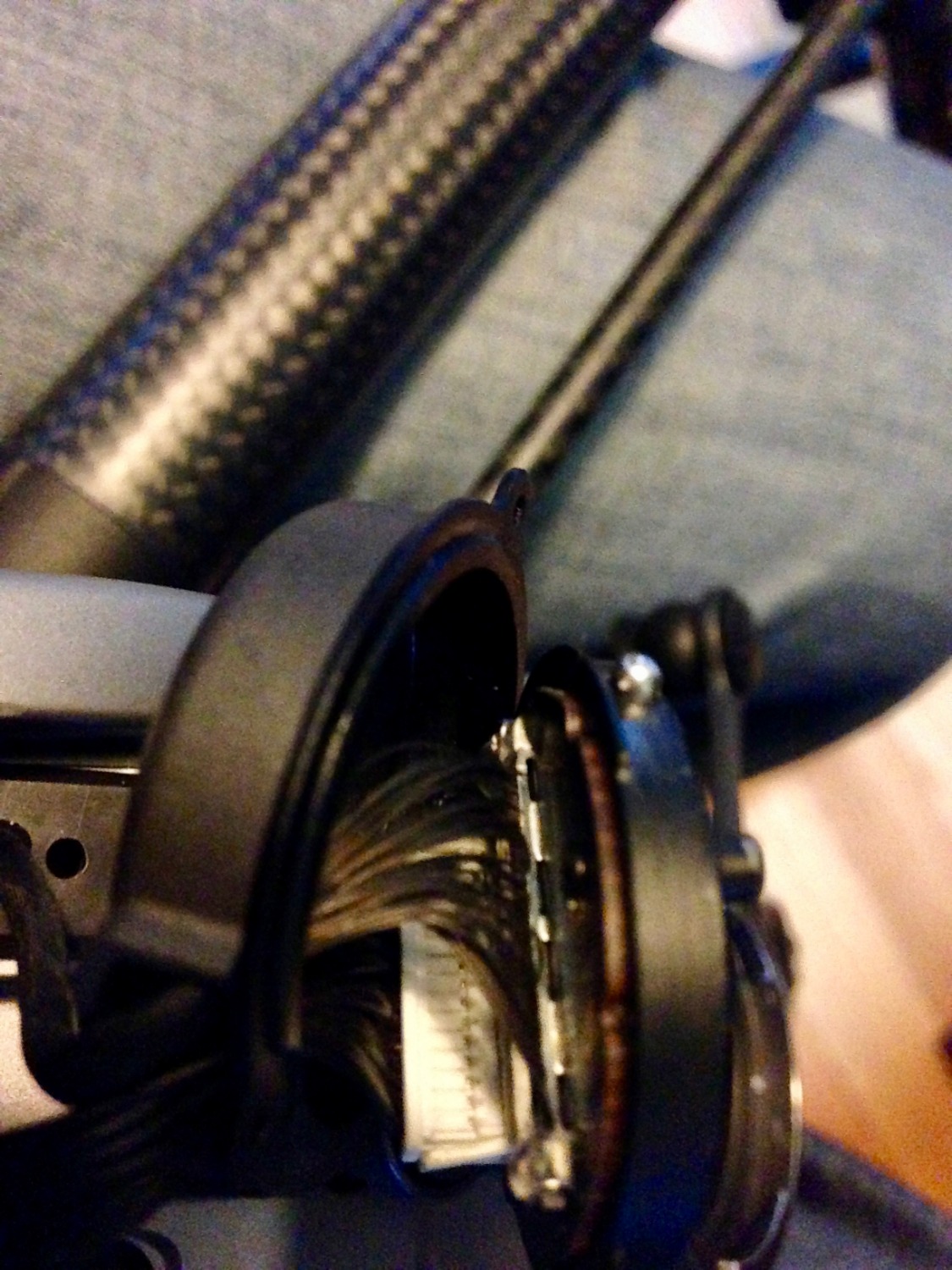

Boy, that's frustrating. I fly a similar configuration as you do. You've done all the steps that I would have done. I'm wondering if it's a physical connection issue either in the camera or in the gimbal to drone connection.  There are a large number of small wires going to a connector on both sides of that connection (see photo-sorry that quality isn't great) and I wonder if there's an intermittent connection of a flaky wire on one side or the other. One thing you can do is to try the chat with Advexture.com https://advexure.com/. They are the largest distributor for DJI on the West Coast. Their chat support is really helpful and they help whether you bought the drone from them or not. Also if you're not on the InspirePilots.com forum, I'd invite you to join us and put this up there as well. Both Advexture and Florida Drone Supply are really helpful vendors in that regards. Good Luck!
