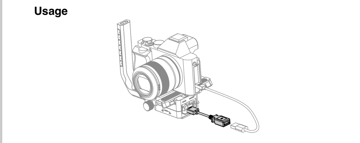

the Sony Camera Setup Method doesn't say anything
When using MCC-Multi:
1. After connecting the cable, be sure to power
on the Ronin-S before the camera. Otherwise, the Ronin-S does not recognize the camera. If the camera is not recognized, restart the camera or remove and reconnect the cable to the camera.
2. The optical zoom can be controlled through the Ronin-S Focus Wheel (only lenses with built-in power zoom, such as the Sony E PZ 18-105 mm F4 G OSS). If a non-Power Zoom lens is mounted, the Focus Wheel will control digital zoom. Digital zoom must be enabled in your camera’s settings.
3. After connecting with a Sony camera using the MCC-Multi cable, if you need to swap to a camera of other manufacturers then a gimbal reboot is required.
What is the camera set up required for Sony a7r2?
