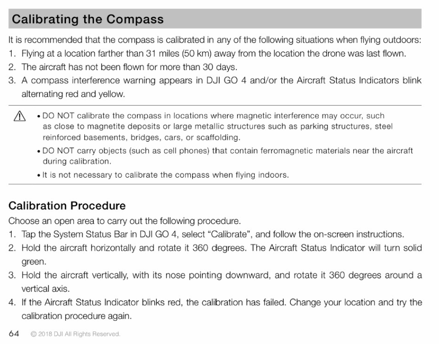

Hello and good day AntDX316. Thank you for reaching out and for the information you have given. Let me provide you additional requirements for proper compass calibration. Do not calibrate your compass where there is a chance of strong magnetic interference, such as magnetite, parking structures, or steel reinforcements underground. Do not carry ferromagnetic materials with you during calibration, such as keys or cellular phones. Do not calibrate beside large metal objects. I hope these helps. Thank you.
[view_image]
I know but in the "image" it shows it as laying down sideways!! for both the Spark and the Mavic 2. Doing it both ways really makes zero difference. |
