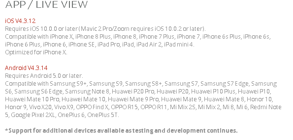

Hi, we're sorry to know about this situation. Thank you for providing the troubleshooting steps that you've done to possibly rectify this matter. However, I highly recommend using a different mobile device to isolate the issue as the iPhone XS MAX is not yet part of compatible mobile devices, therefore, using the said mobile device may cause connection problem. To check if the problem is the USB port of the RC or it's a compatibility matter, you may consider using different mobile device. It would be better if we could try a device that is included in our compatible devices. Thank you for understanding.

In my first post you will see that I have used several iOS devices and several cables and none work. It has worked on my iPhone XS Max just last week!
Just now I installed DJI Go on an android device and that too will not connect to the aircraft. That obviously uses a totally different cable.
So that’s now 4 devices and about 8 different cables I’ve tried.
I am certain the controller is faulty.
