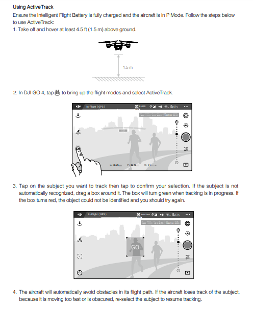

Hi, thanks for the inquiry. The Active track feature can be used without the remote controller, however, you have to have a mobile device that is connected to the aircraft directly via wi-fi. You may refer to the images below for using the Active track feature. Hope that this would clarify your query.
