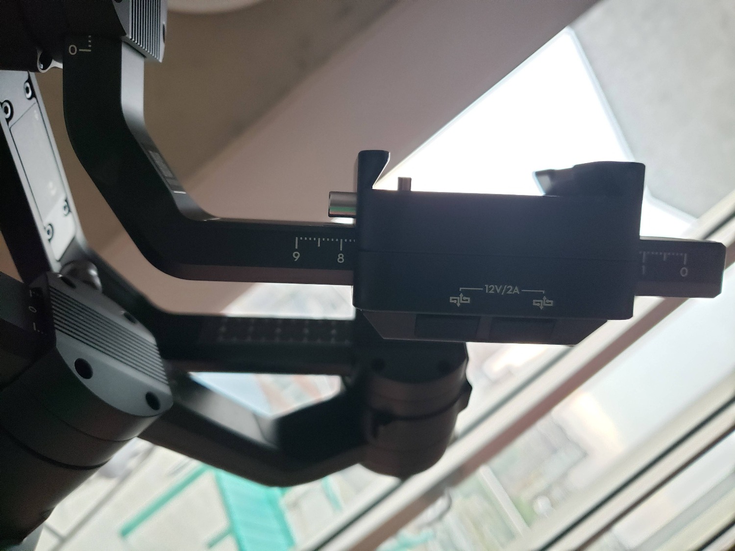

My Ronin S carriage seems to be stuck and won't move towards the left past 7 and 1/2 (see image for reference).
I assume this isn't normal? I don't want to force it because I don't want to break anything, but I need to slide it further towards the 9 to balance it properly. It has been like this since I bought it, but I only just got time to start trying to use it now so I only just discovered this.
What can be done? Is this a common problem? What can I do to fix it?

That's weird. It isn't lost when I look at it. Here's a URL you can view it.
https://i.imgur.com/cP0Bghn.jpg
It's not much to see though. It's just the carriage parked at 7 1/2 where it can't slide any further towards the 9.

Mine stops in the same location.  Been that way since I got it.  Be interesting to see what DJI says.  Other than that, it works great!

Same with mine.

ANSWER: I just spoke with DJI customer support. According to manufacturing engineers this is a NORMAL feature of the Ronin S in order to help prevent a mounted camera from hitting the gimbal.
