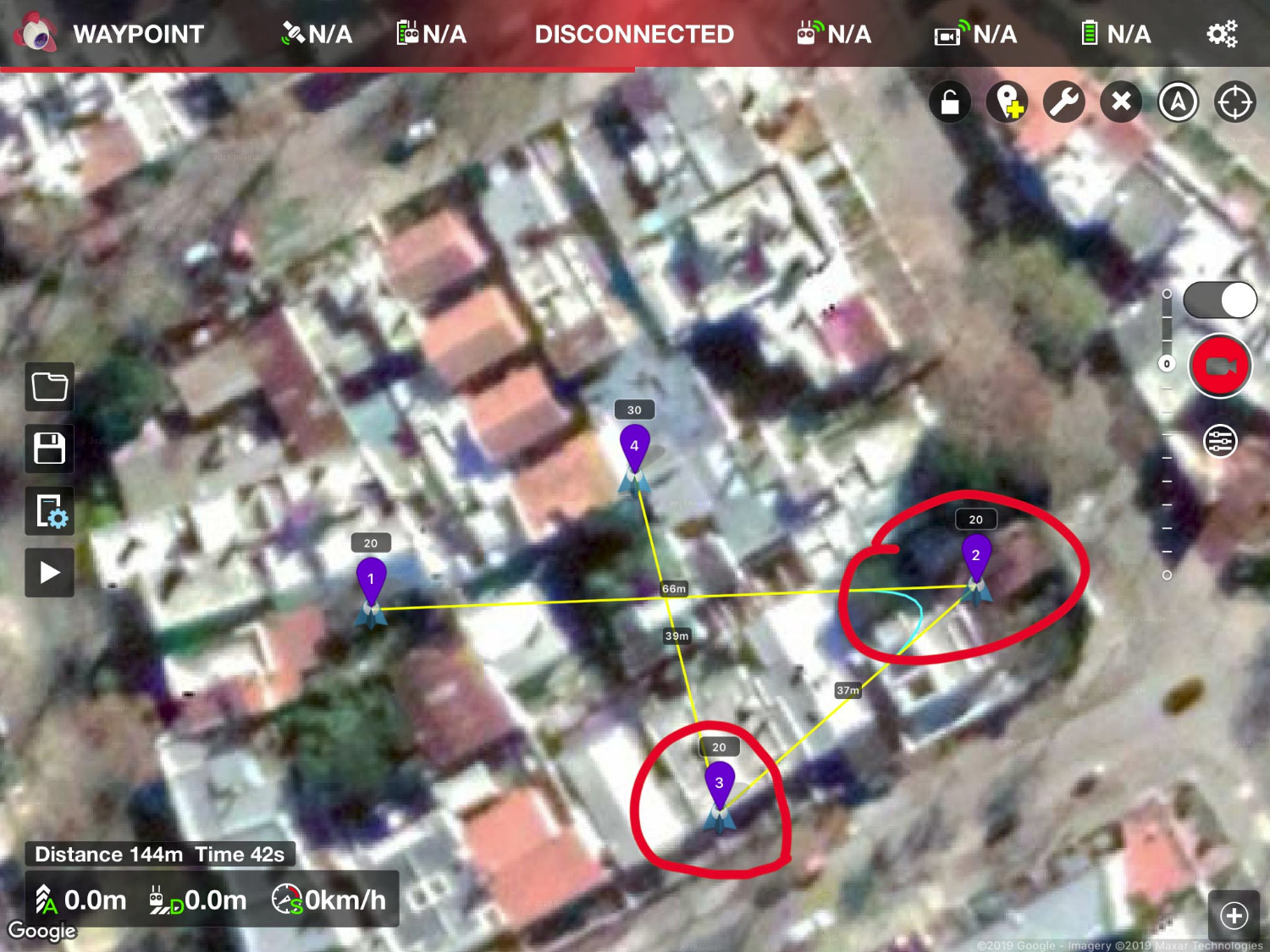

Yesterday I had only 3 WP.
After I changed from straight Path Mode to Curved Turns and Default Curve Size: 0% a curved path was drawn in WP 2.
Today I added WP 4 but WP 3 path didn't change to curve.
The flight was exactly like the drawn path with curved line at WP 2 and no curve at WP 3.
No stop at WP 3 as I wish.
I created a new mission starting with Path Mode to Curved Turns and Default Curve Size: 0%.
It didn't draw green curved paths in intermediated WPoints
I think it is a Litchi bug when I change from Straight to Curve (size = 0%) and it draws a green curve, It doesn't make sense.
I also have a 10 WP I have to fly.
I made the same general settings change: Path Mode from Straight to Curved Turns and Default Curve Size: 0%
Strangely 3 of the 8 intermediate WPs where changed to green curves.
Even further if I change Curved Turns Default Curve Size to larger values, nothing changes in the path.
Those 3 WPs have the same green curve whatever the % I set and the rest of the WPs remain as "straight", no curve.
PS:  After turning from Straight to Curved it is not possible to adjust each WP curve size
PS2: I am able to change Curve Size to 0m to the WPoints that are not already set to 0m only using the Hub, not in the iOS app
