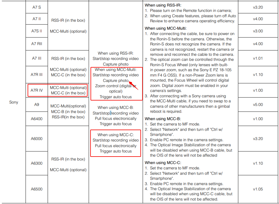

Same issue here. No solution at all?
Editing my post: it seems that all is related to the MCC cable.
Neither usb-C nor microUSB can control the camera, another cable is needed to do this: the MCC Multi.
The pic shows about the a7rIV but if you look about the a7III is just the same.
