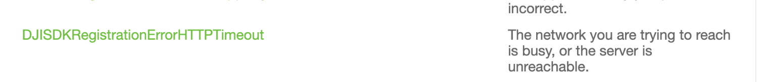

Here you can see a list of these errors: https://developer.dji.com/api-re ... isdkgeoerror_inline
And as you can see this message is thrown after an http timeout - so a couple things to check:
