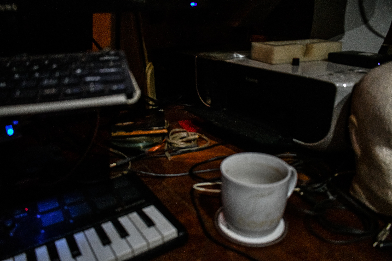

I have an issue about my pocket 2 when i try to use pro mode. I don't know if it's normal.
I start with normal mode and exposure is perfectly fine.
When i switch to pro mode  with  this parameter 4K 60 fps. Shutter speed 1/120 and iso auto max 100 ,Normal color,  the exposure fall to -3.0.....
the simple fact to activate D-Clike color and desable it right after, change the exposure to normal 0.0
Then when i turn off and turn on the camera, the wierd exposure comes back.....
Looks like a bug or i missed something
Please help me
Here is a video show you :

When you go into the editing screen and make your settings you set the ISO, shutter speed and amount of exposure compensation yes?
Those are the values I see on the screen of your video.
Then on playback the -3EV it is showing is showing how much the scene is being under exposed by and not your initial setting.
Notice how the value changes as the camera spins around.
I would think that would be normal information behavior.
Ray.

Kamikazeguisan Posted at 11-27 03:36
But how do you explain that the simple fact of changing the color mode , change completely the exposure . It’s not supposed to be black with a shutter speed of 1/120. And iso to 100.
And why when i turn off and turn on the device , without making any changes, the exposure become black again....
First, If I'm misunderstanding what you are reporting ignore the rest of my post but.
I would say in low light with a shutter speed of 120/s and at ISO 100, all I would expect to see is a black screen.
So I got out my full frame DSLR that is 20MP. The photo-sites are hundreds of times larger and more capable of collecting light than the sensor of the Pocket. I took two shots in my workroom where light levels are low. How much lower than where you shot your image I have no idea so results could be different but bare with me.
With the same manual settings you used this was the result.
On auto ISO the camera had to go to ISO 40,000 before it would start to expose.
My camera even had slight difficulty in focusing.
I really feel you have to experiment with manual settings to see what will work in a given lighting condition if you insist on going full manual. There are physical limits you have to work within.
I am surprised I got an image at all.

Have you tried with this setting and this dark exposure, to switch on D-cinelike color mode and instantly switch off then check your image.... it is completely different and well exposed.
Do it while you’re using pro mode without any changes

Ray-CubeAce Posted at 11-27 04:29
Sorry i forgot to reply directly to you message so please check my previous message.
I think it’s a bug inside the firmware. Because turning on and off something without any other changes shouldn’t change the result like this. And i’m talking about color mode switch.
Loom at my video, i just activate d-cinelike and turn off immediately.

Kamikazeguisan Posted at 11-27 05:10
OK. Sorry I misunderstood.
Good catch. I think you are the first to spot this.
