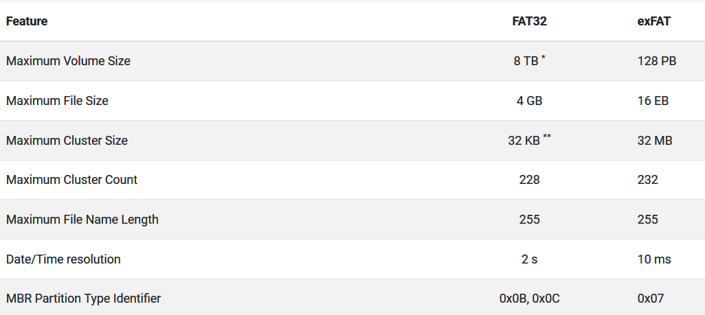

After reading your story, I continued to study exFat because I did not understand that adjustments to 14.3 characters did not cause a problem before. I found the table below which states that file names up to 255 characters in length are supported. Since exFat is supported according to the manual, this shouldn't really be a problem. Hopefully DJI finds out what the long name problem is. A mini 2 that no longer responds to anything without explaining why is very frustrating. |
