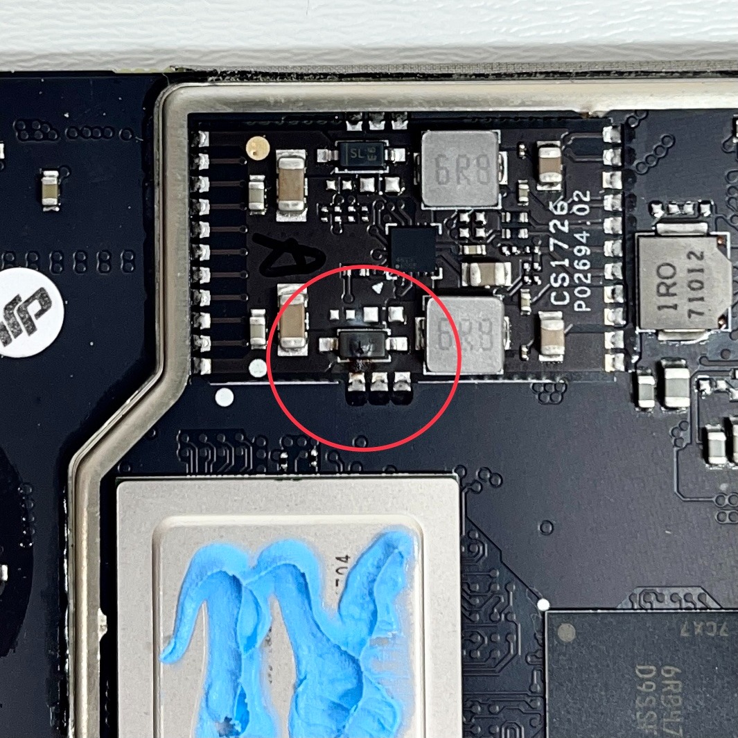

I'm a curious fellow, so I opened up the screen and replaced the main board in the Ultra with that of a Hi-Brightness and the Ultra now works, so it is definitely a main board issue. While making the exchange I noticed that the main board obtained from the Hi-Brightness screen had much more thermal paste between the cooling coil and itself. Suspicious that the lack of thermal paste between the two was what caused the issue, I removed the cover and found that one of the diodes (SL E6) is blown, as seen in the circled region of the photo below. Is this covered?

Thanks for keeping us updated. If this is covered under warranty, the unit must first be within the warranty period to be considered, and second, is that it would pass the damage assessment (issue must not be caused by user error and within the after-sales policy: https://www.dji.com/service/policy). If both conditions are met then it could be repaired for free. Please check out our Customer Support: https://www.dji.com/support to assist you to open a ticket.
