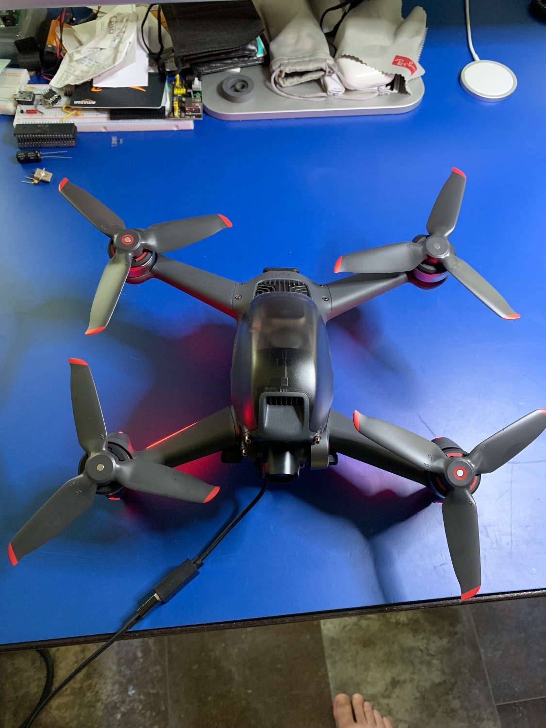

I cannot get firmware to transmit to my Brand New FPV using a Mac, running macOS 11.4 Big Sur
So, it's basically useless, and will not fly. The camera does transmit to the goggles, which also recognize the remote, but that's it.

> My system detects the drone when it's powered on and let's me attempt to install firmware
> It has to download the firmware again from the internet EVERY time I select this option, but it gets stuck at 0% Transmit every single time??

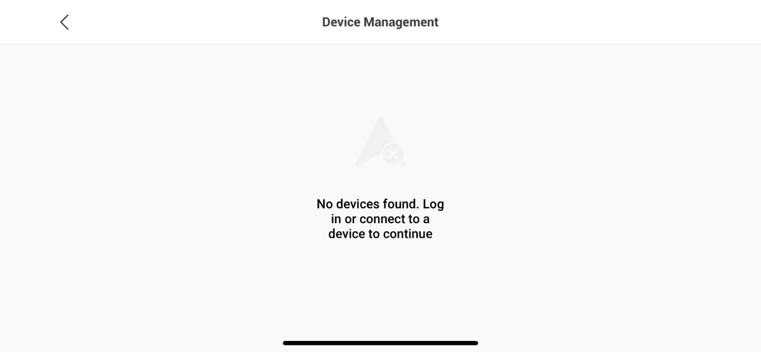

Separately, I've tried to install firmware from my iPhone XR, using DJI Fly
> However, this doesn't even DETECT my Drone?
