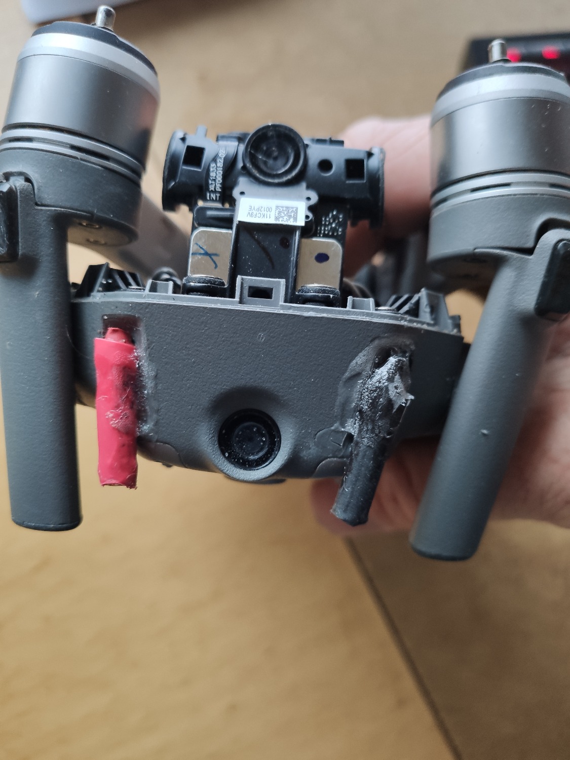

Very good ideas to think about.  What is the drone in the picture?  Is it tethered?

Its a mavic2
The red and black is power direct to the drone. Its my lab setup, so I don't have to use batteries when running in sim.
The red and black connectors can be used as tethered but it also can act as power until the drone takeoff. In the last case I just put some loose cables in the red and black connectors, that easily disconnects at takeoff.
