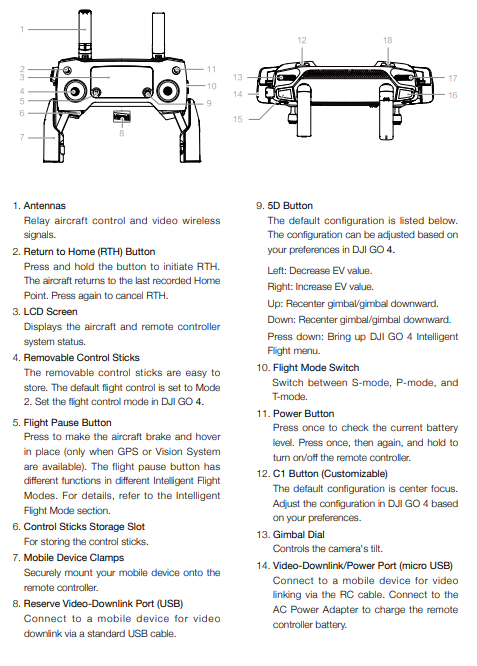

I am trying to get my Pro 2 access 'Tripod" mode.  I know I have had it working previously but I can't get it anymore.  I go into "inteligent Flight modes", but the tripod function isn't avaiiable.  Help please!

Is the Tripod mode not available by just using the sliding switch on the remote?

On the M2 there is a switch on the right side of the controller to change modes.  In settings you need to turn on allow flight modes.

Hello there DCN97. Good day and thank you for reaching out. As posted above by FloridaNext and DAFlys, you can locate the Flight Mode Switch on the right side of your DJI Mavic 2 remote controller for you to be able to select Tripod mode. Thank you.
