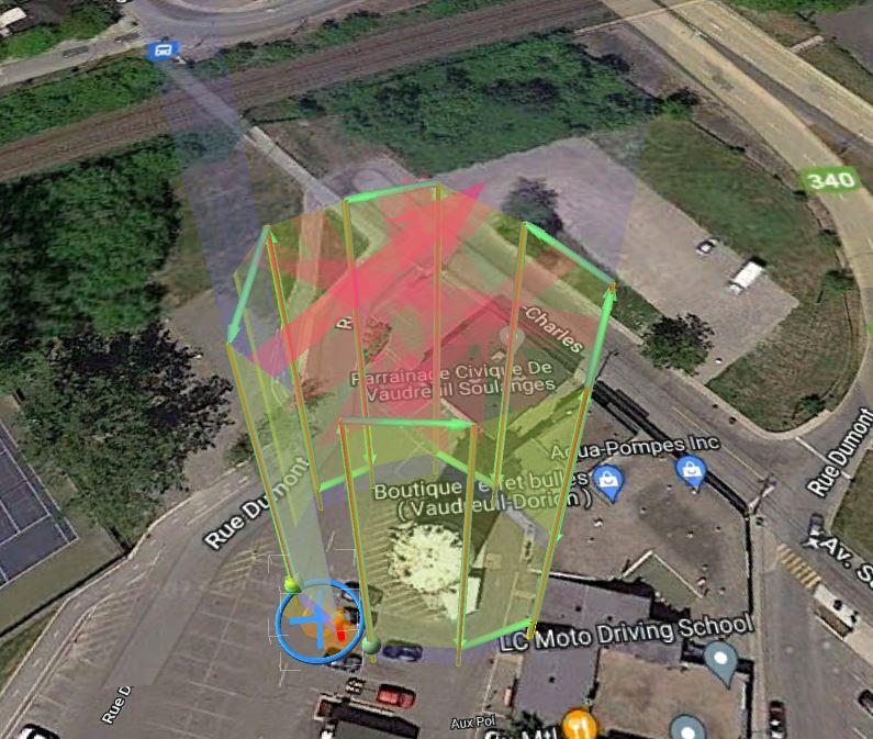

I recommend that you activate the grid, I don't remember if it's available on DJI FLY.
If so you will have a rectangle in the middle of the image.  Starts from a point on the ground, then going up takes each photo with the size of the rectangle as an interval.  This should ensure an overlap of about 70%, more than enough.
When you arrive at the top, you shift to the right or to the left, taking the rectangle once again as a reference, then you go down, then you shift again and go up... until you come back to the starting axis.

It should look like this more or less:
