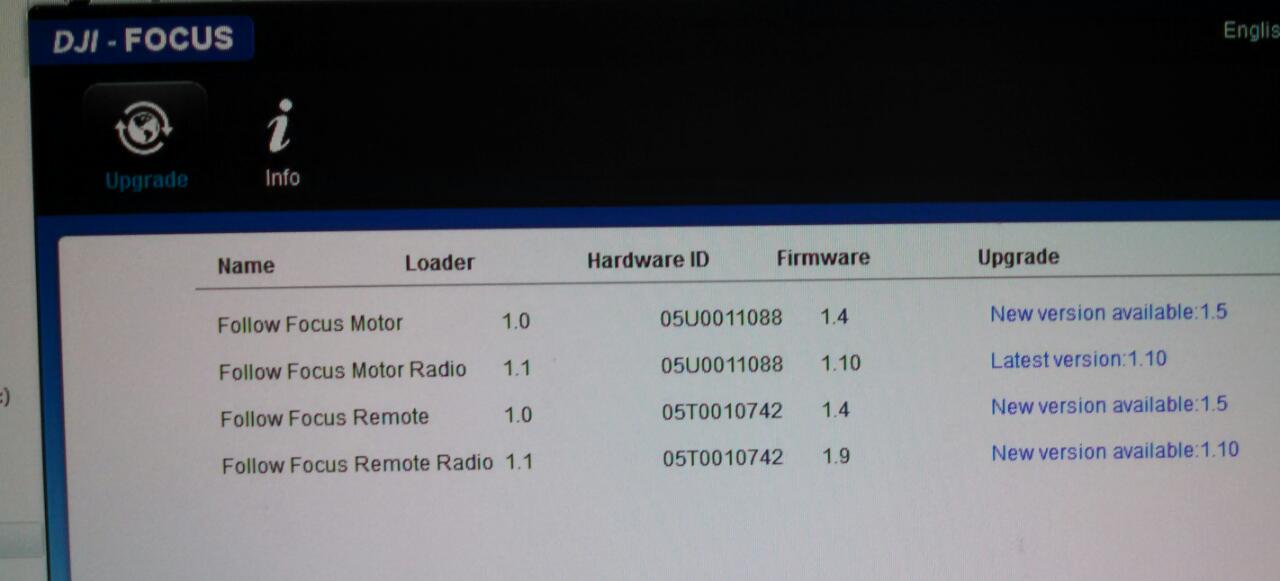

I tested the dji focus on the ronin-m and the only option "torque" doesnt work well, at "min" it responds smooth with lot of delay, at "normal" it just doesnt work smooth, it jumps steps, vibrates. At "max" it gets worse, it vibrate more, jumps more (instead of smooth travel it gets jerky and abrubt), and it even lost connection to the point that it take 2 full seconds for the motor to respond. As i said in the first post, "Cali torque", "Run torque", "speed" and "Acceleration" options are no longer available in the menu, just "Torque", "direction" and "rack speed" are in motor parameters |
