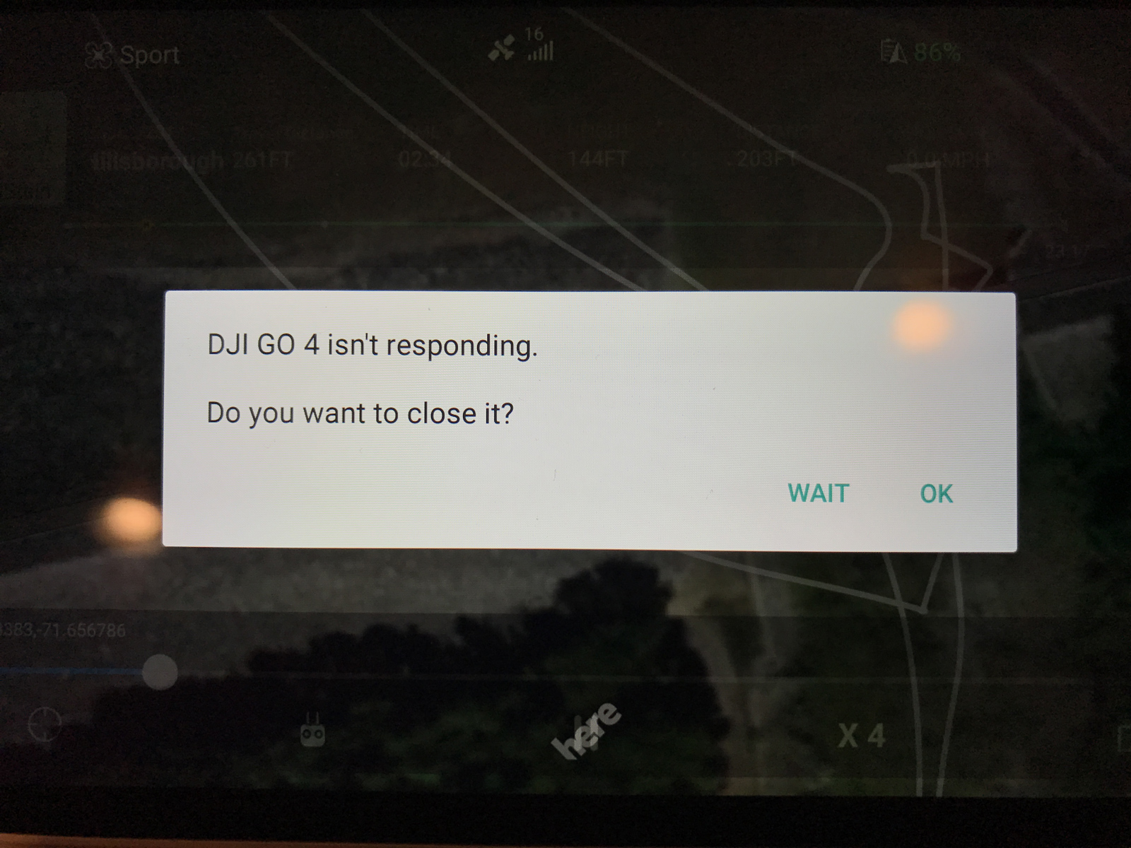

Really, really frustrating and makes the entire system unreliable for flight. I have had my P4P+ out quite far and had the screen stop responding. Is the symptom the same as you guys? When can touch the screen, it makes the "pop" sound but there is no other response. You can't touch controls, buttons or anything, it just keeps making the touch 'pop' sound.
Then, usually after a few seconds, I get the screen prompt shown below "DJI GO 4 is not responding. Do you want to close it?" with "OK" and "Wait" options. Wait never works. I usually have to touch OK, or long press the table's button on the side of the P4P+ screen to force the table to reboot.
This should be among DJI's highest priorities to fix this. I ordered the Plus because they control the hardware, I figured, how hard could it be to get it right since they can test and control and hardware and software (versus trying to accomodate many different models of Android and iOS devices).
stop responding
stop responding
