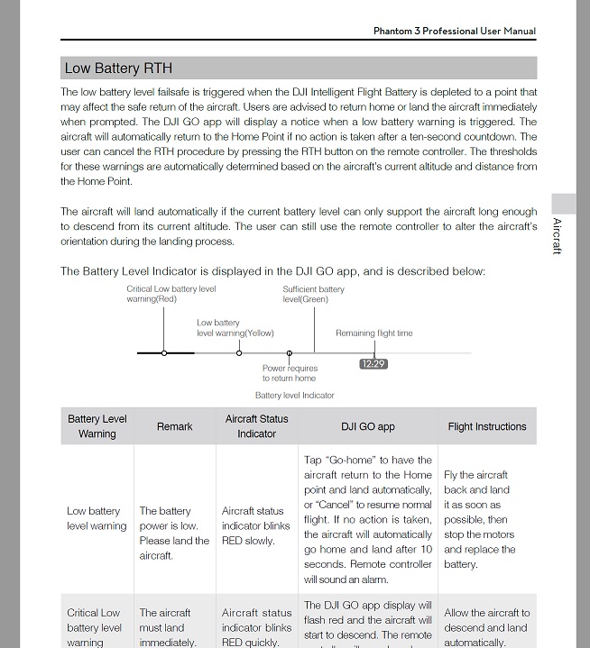

"while activating "Smart Return Home" in the app options just arms the RTH for "low battery in regard to distance" situations. "
If that is true then the problem would be that the control switch in the App' needs a name change from "Smart Return-To-Home" to something more meaningful like "Low level battery RTH"
That would then clear up any confusion surely.
"because there literally is no "Low Battery RTH" to be found in the usage of the P3P... "
This extract from the P3P manual seems to describe "Low Battery RTH" quite well.
The aircraft should RTH when it hits the yellow 'H' marker (Power required to return home) at the start of the 'low level battery warning' yellow marker on the battery timeline.

Aardvark Posted at 2017-1-16 07:36
What you describe is what I meant:
generally RTH can be called "smart", sure. The problem: what is called "Low level battery RTH" in the manual is called "Smart Return-To-Home" in the app. This again collides with the term "Smart RTH" in the manual which just stands for pressing the RTH button on the RC or in the app.
The most definite solution would be, as you mentioned, to rename "Smart Return-To-Home" in the app to "Low level battery RTH".
This way the three terms "Smart RTH", "Low level battery RTH" and "Failsafe RTH" would be used comprehensible...
