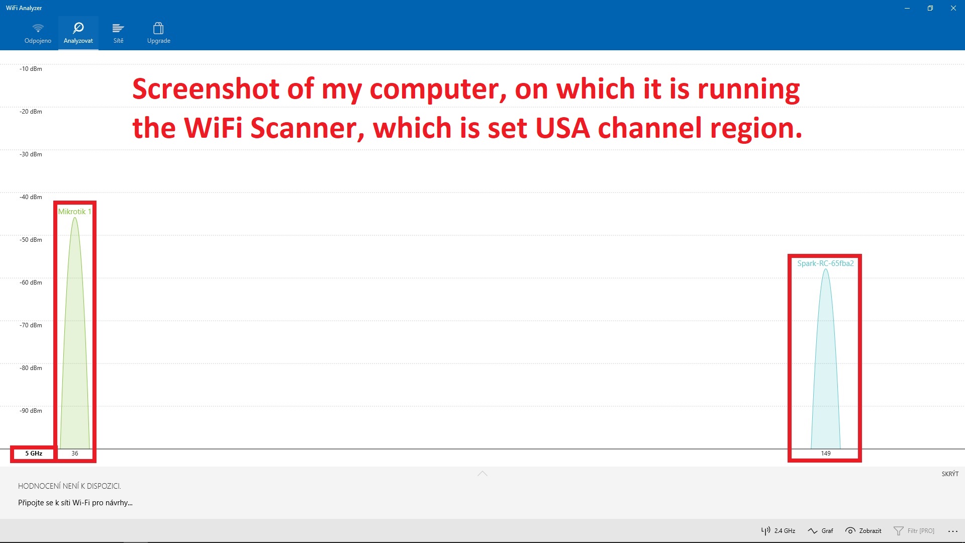

I am adding screenshot from WiFi analyzer running in my phone. You can see the 5Ghz band of WiFi channels that Andoid uses in my country (Czech Republic). If You look on Spark 5Ghz band WiFi table you will see that they are different (Dji GO, settings, wifi, CHANNEL INDEX).. Everything is visible on the enclosed screenshots (please read comments of screenshots).

Screenshot running WiFi scaner on my phone
Dji Spark WiFi channel table
WiFi scanner runing on my computer
