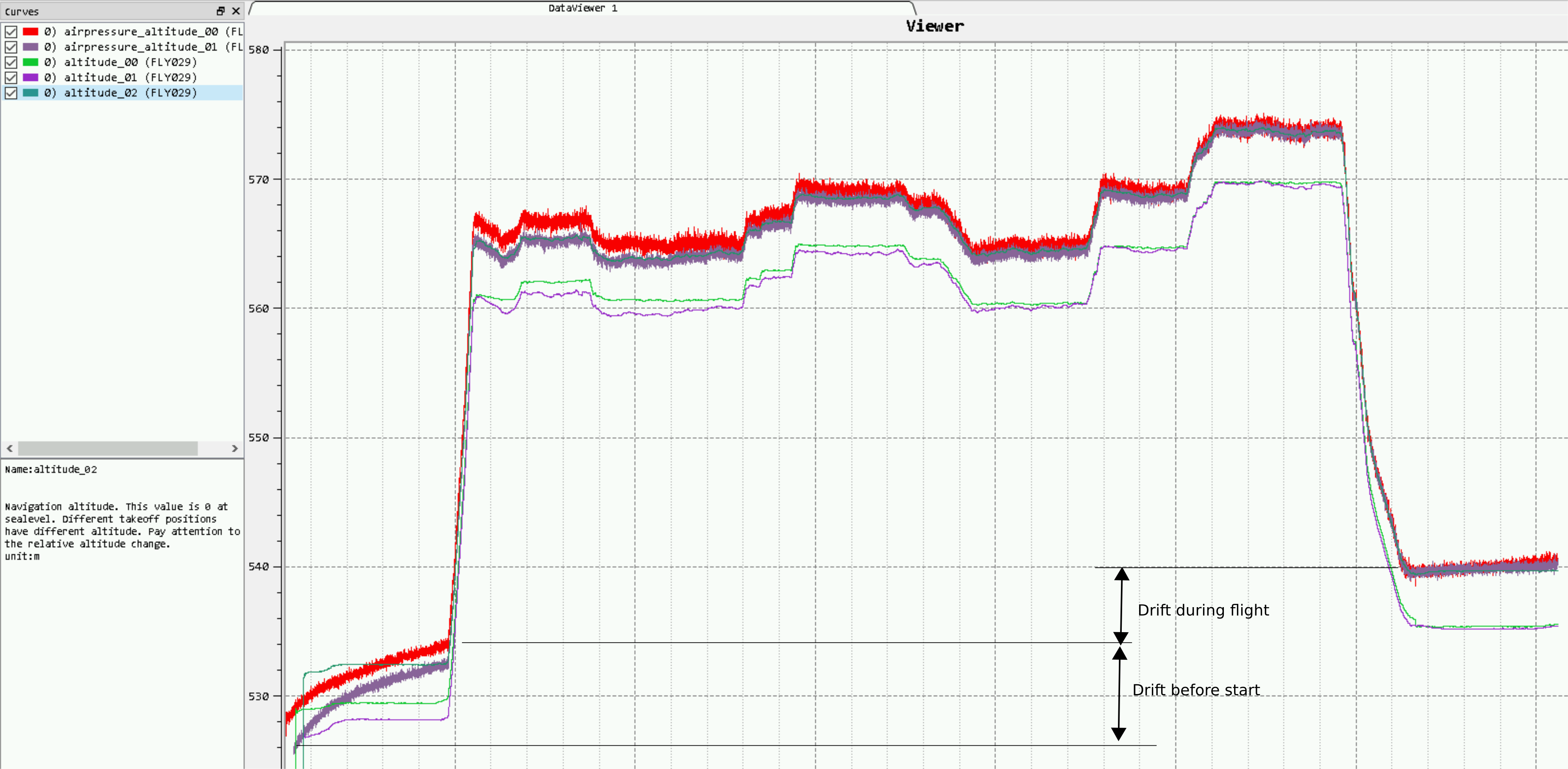

I recently did some testings on the ground:
- For the first run, I took the M600P out of my office and switched it on so that it was still at room temperature  at t=0
- For the second run, I left the M600P for 2 h outside in the cold without power supply and then switched in on using a battery pack that was in my office before
The readings between the two setups differ largely:
My impression is that the sensors may warm up if in use, leading to the dramatic drift of 25 m (red lines). Nevertheless, the other setup also led to a drift of the sensors, readings did not stabilize before 10 minutes!
