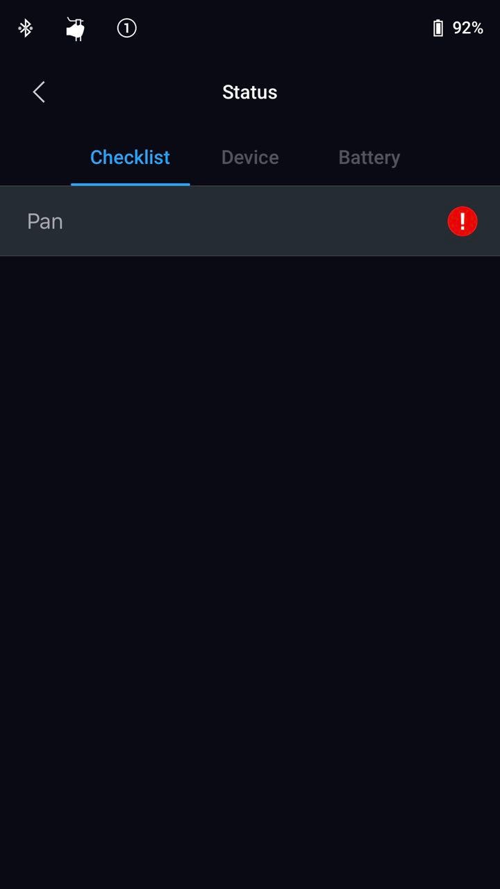

I just got mine yesterday, balanced it out and powered on. The gimbal is powered but the motors do not move at all! Tried upgrading the firmware too but no change. The only error I get is in the app is the status shows a red ! for PAN. Although I have balanced out the Pan as well.
Any thoughts on what the issue maybe?

Hi there, yes the Ronin S was activated successfully but the motors dont work and I cannot update the firmware. I get an error message suggesting the device is not connected (photo attached)
Also, I have attached a photo of the Status issue. Although the Ronin is fully balanced, I get a stastus error with Pan!
Can you send me an email so I provide you the SN privately? I am located in Toronto, Canada.

Hey man,
I am experiencing the same things stating that the Pan status has (!) with it. Its on but the motor does not work as. Did DJI gave you a solution?
