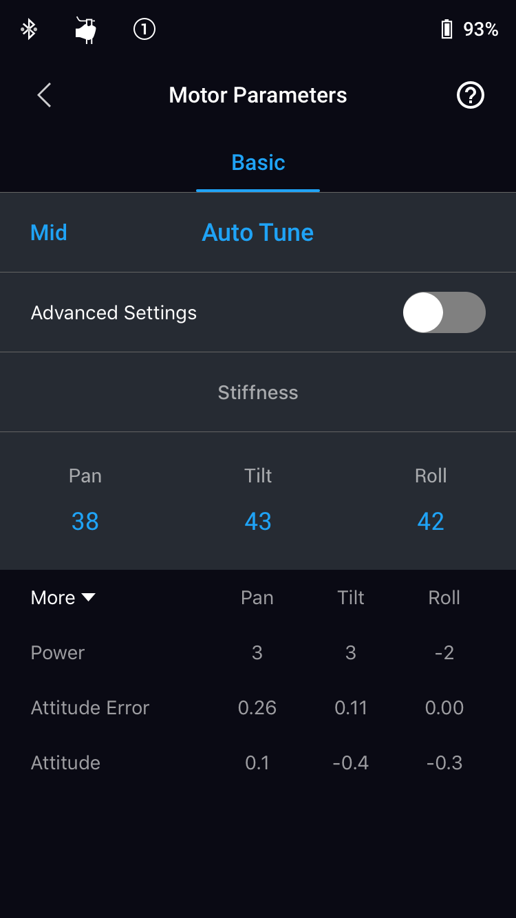

Hello everybody!Balancing is done properly ( I'm ex-Zhiyun Crane user ), autotune at medium level. Calibration gives me "Excellent" on all axes. If I tilt or pan and return it to the center, the camera never really returns to the same position. I have to double click the trigger to recenter it again. Tried with both heavy and light setups and different response modes. It returnes to the center position only in Sports mode... Any adwise would be highly appreciated. I have a paid shoot in 4 days and thinking of returning Ronin S and getting Crane 2 back as I know this gimbal inside out and know how to cope it's issues.

Hi all, sorry for my late response and the troubles with the Ronin-S. Please try the following steps to see if it works.
1. Push and pull the joystick several times to change the axis’s position if it is not centered, stop operating the joystick after the axis arm is in the centered position.
2. Press and hold the joint angle in the app for about 6 seconds to start the joint angle calibration. Then click “OK”.

Let me explain the logic of how SmoothTrack works.
We allow the user to set a deadband which is a window in which the gimbal doesn't react to your movements. For simplicity's sake, we'll use values and make them equal to degrees. We'll set a deadband of 30. This means if you perform a panning motion, and rotate 30 degrees left and 30 degrees right, the camera won't follow your movement. Once you get past 30 degrees one way, the camera will start to SmoothTrack or follow your movement.
With a setting of 30, SmoothTrack is only activated when you go past this deadband window of 30 degrees. Once the movement/camera has caught up, SmoothTrack stops following. This isn't a random position. It's when the gimbal has caught up and it enters back into the beginning of this deadband window. The larger your deadband, the more apparent this will be. Now if you set a smaller deadband of say 0, it will follow and look like it appears much closer to center when you stop your movement. However, with such a small deadband, movements beyond 0 degree may result in an unprovoked follow motion.

I think I just found an actual solution! In the smooth track pan menu put the sensitivity to 100 in the custom mode,  put deadband to 0 and  speed to 100.  Repeat for tilt. Seems to do the trick.Let me know if this works for anyone else

After lots of testing, I can see that the recommended DJI settings cause a lot of issues (mainly the movement is too stiff, especially the roll with all smoothtrack set to 0 deadband and 100 sensitivity).  The settings from their email above.  So I started with their settings, then made parameter adjustments.  Here's my steps and some screenshots.  My goal has been to get the Ronin-S to perform as close to the Osmo as possible.  It's not perfect.  But it's better.  Here's the info:
Step 1: Balance
Perform balance calibration and achieve excellent results on all 3.
Step 2: Joint Angle
-Set the Ronin-S on a level surface.  Double tap the trigger, or use the joystick to perfectly center the gimbal.
-Perform the joint angle calibration by going to motor parameters, advanced options, hold down on joint angle for 6 seconds to calibrate and hit ok.
Step 3: Smoothtrack (I have PUSH turned off for all 3 motors) And I started by customizing the User 1 setting.  Meaning the green light on the Ronin-S is on "1"
-Pan (Speed=Medium, Deadband=-, Sensitivity=100) Note that changing speed to low makes return to center slow, and high makes it fast.  Lowering sensitivity will reduce the chances it will return to center.
-Tilt (Speed=High, Deadband=0, Sensitivity=100)
-Roll (Smoothtrack is off)  DJI recommends this to be on at 0 headband and 100 sensitivity.  But this will create a visual roll in your shots and feel like you're on a rocking ship.  That is no good.  This must stay off.  However, make sure to not roll to hard or the roll arm can hit the pan arm.
What I've noticed with these settings is that the Ronin-S is performing pretty smoothly and coming close to returning to center.  It's not perfect but it's better than it was.  And it's not as smooth as advertised, but that's also better than it was too with these settings.  But FOR SURE, the DJI presets (1,2,3) are bad that they ship the Ronin-S with...bad as in do not perform normally.
Now...I believe somehow you can set the roll motor parameters somehow to not roll so far as to hit the pan arm, but I'm not sure how at the moment.  I hope this helps as I've been having serious issues with this piece of equipment and I own a production company with a huge gear inventory.  This is by far the most finicky piece of gear that, unlike other DJI products did not work out of the box.
