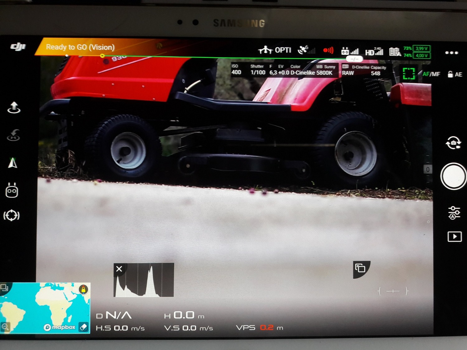

I think I am in the same boat here with X5s !
I am just upgrading firmware with latest release v01.02.0300 dated on 16-11-2018 in Europe.
Now the FPV does not display any video stream. The rest is working well (orientation, X5s, etc ...).
I do NOT used CrystalSky, I am running DJI Go 4.3.4 App on Samsung Tab S and Tab S3
I don't know the behaviour on iOS.
I have launched downgrading with DJI Assistant 2 to check if the FPV is working back. But no change.
How  your issue was solved ?
