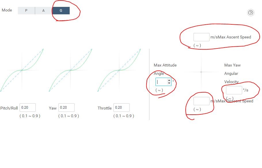

After updated to 1.7.6.0 I can no longer change and save the gentle mode Controller Exp settings. Therefore, G mode is no different than P.

Do you use LB2 or S-Bus?
Try DJI Assistant 2 For Autopilot v2.0.2 from 2019-01-09.
Uninstall older versions first. Then perform a factory reset (dashboard restore) and edit the settings.

Thanks for the reply WiSi
I'm using LB2. Just uninstalled DJI Assistant 2 for Autopilot and reinstalled. I was only able to find V2.0.0
https://www.dji.com/downloads/so ... dji-2-for-autopilot
After doing a factory reset On G-Mode I'm still getting blanks in the controller EXP.
P,S,A all show normally

I also flew it with these blank values and it behaved the same as P-mode so not very gentle. I have a quad with 30" props so I don't want to get sporty with it. It's meant to be flown pretty slow.

I had a similar problem. Exp did not toggle between the modes. But with 2.0.2 it works, see screenshots.

I found the 2.02 version and installed it. Thank you. However, my G mode is still not showing properly. Can you double check on your G mode shows up. I see P,S,A on your screenshot.

OK, you are right. G-Mode does not work.
Maybe a workaround: use P-Mode and lower the values.

Yes, for my workaround I'm using S as the G mode with very low speeds/angles. I'll call it Slow mode instead of Sport.
Maybe another update will fix it. I would have stayed on the old firmware but they fixed the output bug with the M600 Expansion Module.
