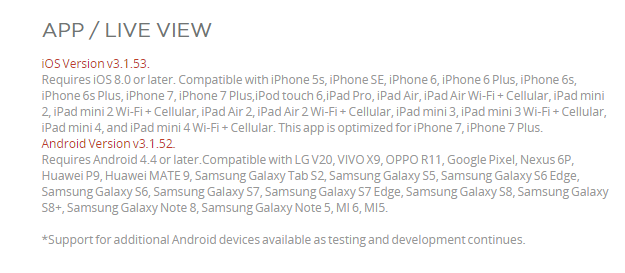

Hi, Good day Defik. Thank you for the additional information. Upon checking here in regards to the mobile device that you are using. I am sorry to say that the Huawei Mate 10 is still not recommended. Actually, there is a possibility that the Huawei Mate 10 will work, however, since it's not yet optimized with the Phantom 3 Advanced and with the DJI GO application we cannot guarantee the stability of the Huawei Mate 10 when in use with the said device and with the said application. We highly suggest you use the compatible device that was listed on the recommended mobile device list below to avoid any problem. If the remote controller firmware upgrade failed, try with another mobile device on the recommended device list and conduct upgrade again. You can refer to the list of the compatible device here:

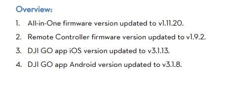

In addition, We highly recommend checking the drone's firmware if it has the latest firmware since if remote controller firmware version v1.6.0 or newer must be used with the latest aircraft firmware.

Hi, Good day Defik. Thank you for the additional information. Upon checking here in regards to the mobile device that you are using. I am sorry to say that the Huawei Mate 10 is still not recommended. Actually, there is a possibility that the Huawei Mate 10 will work, however, since it's not yet optimized with the Phantom 3 Advanced and with the DJI GO application we cannot guarantee the stability of the Huawei Mate 10 when in use with the said device and with the said application. We highly suggest you use the compatible device that was listed on the recommended mobile device list below to avoid any problem. If the remote controller firmware upgrade failed, try with another mobile device on the recommended device list and conduct upgrade again. You can refer to the list of the compatible device here: [view_image]
In addition, We highly recommend checking the drone's firmware if it has the latest firmware since if remote controller firmware version v1.6.0 or newer must be used with the latest aircraft firmware. [view_image]
I have also tried to installing the dji go app on my wife her Note 8 phone but with that phone i have the same problems.

now i see that the Android app wich i am using is the 3.1.52 version and not the V3.1.8. version.
In the playstore this is the only version wich is applicable at this time. Can i get the latest version from anywhere else?
