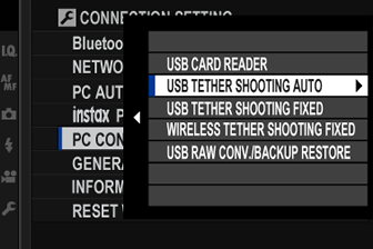

I am trying to connect my Fujifilm T-20 to the Ronin-SC but I am getting a black screen with a USB sign. I do not have the option to select "USB tether shooting auto" on my camera. Can someone help me solve this issue?

robert.sarasin Posted at 5-2 11:46
That is the problem they are also having, as the camera has no USB tether option in the firmware. So the X-T20 doesn't support the USB control cable at this point, only the RSS-Cable for Fujifilm, which is an optional accessory.
