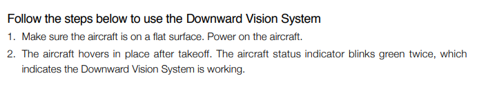

Hi. I am sorry for the trouble this has caused you. With regards to the Downward Vision Sensor error. I would recommend please try to do a firmware refresh using the DJI Assistant 2 on the said drone to isolate the issue. In addition, I will be posting an image for more details about the DJI Mavic Mini's Downwards sensor. Please keep us posted for further assistance. Thank you.
