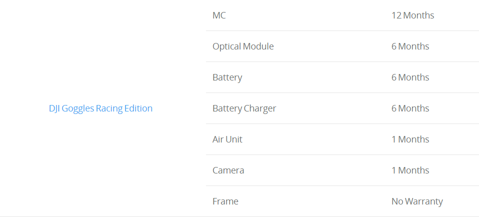

Hi there, we checked your order number, it is the DJI Goggles Racing Edition, you may refer to the warranty period of it from DJI official web:
https://www.dji.com/service/policy
I'm afraid that your Goggles has been out of the warranty period; Under this situation, you are recommended to send it back for a check first, the team will provide you with the quotation accordingly.
If you are unable to apply an online repair request, please kindly contact our support at the link below to open a case and send it in. http://www.dji.com/support
