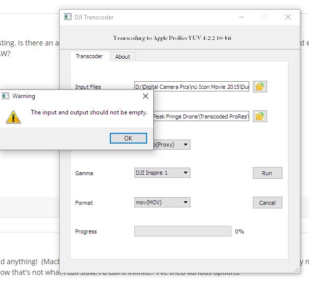

If only the converter actually did anything!  (Macbook Pro).  I know you said 'relatively slow', but 45 minutes and absolutely nothing has been output, for a single 27 second clip??? Now that's not what I call slow, I'd call it infinite.  I've tried various options.

alansworld@gmai Posted at 2015-12-4 23:01
If only the converter actually did anything!  (Macbook Pro).  I know you said 'relatively slow', but ...
Have you installed the right version? For MAC, you can download the DMG version. The EXE version works well on my windows PC.

DJI-Amy Posted at 2015-12-7 06:37
Have you installed the right version? For MAC, you can download the DMG version. The EXE version wo ...
I think you'll find that no .exe will even load on a Mac actually.

alansworld@gmai Posted at 2015-12-7 16:42
Hi, alansworld, I've contacted the R&D, the current MAC version is not working very well, we will post v.0.9 later. Sorry for the problem caused.
