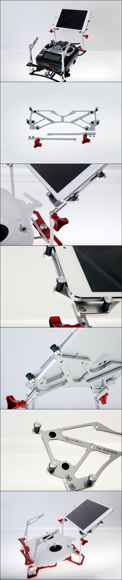

Second best thing is the Secraft Radio Tray
Comes with shoulder straps. And also comes in different variations. Also sits great on my beer belly.
Better user control of the radio.

Bro, this is awesome! Looks so much sturdier than the Satechi Mount I am using now for the iPad Mini. How does the iPad mount to the tray? I looked on Amazon and can't tell.

On the Ipad mount version there is built in knobs that holds it in, very securely.

hd_ultra@msn.co Posted at 2014-9-26 23:00
Comes with shoulder straps. And also comes in different  ...
That's a nice setup!
Can you post some photos showing how that iPad Mini is attached to the brackets?  I normally use my 7-inch Samsung Galaxy tablet for FPV flying, but I'm buying a 12-inch Samsung Galaxy Tab Pro (with hood) for anticipation of maybe upgrading to Lightbridge HD FPV sometime next year.  I'd like to have the option of swapping out either tablet depending on my mood for that particular day, and I imagine the extra weight of the 12-inch tablet will make it unbearable after a couple flights.
Thanks for the help!

This is for The Ipad Mini.  You can use double sided tape and or velcro to secure it. The do have other styles of this mounting brackets.
If you had a outerbox you could just screw in the outer shell to the mounting bracket. You could get something like this for your device.
OUTER BOX
http://www.secraft.net/shop/step1.php?number=1264

hd_ultra@msn.co Posted at 2014-9-27 03:09
This is for The Ipad Mini.  You can use double sided tape and or velcro to secure it. The do have ot ...
Yes, the outer box is a nice way to secure it to the backplate --- but just wish there was an easier way to swap out different size boxes since a 7" box aint going to hold a 12" tablet, and vice versa.
But I could probably just use Velcro strips of some kind to attach either tablet to that backplate.
The main chassis on that SECRAFT Kit is a nice place to mount the large battery pack I use to power my (2) Sunhans booster amps.

That is what I did with my first one. At first I used Double sided 3m tape. And then went with the velcro.
The first one I got did not have the pins holders for the Ipad 3. The Ipad 3 was too large for me. That is why I went with the mini.
I would think that there is some kind of holder out there that you could mount to the bracket.
