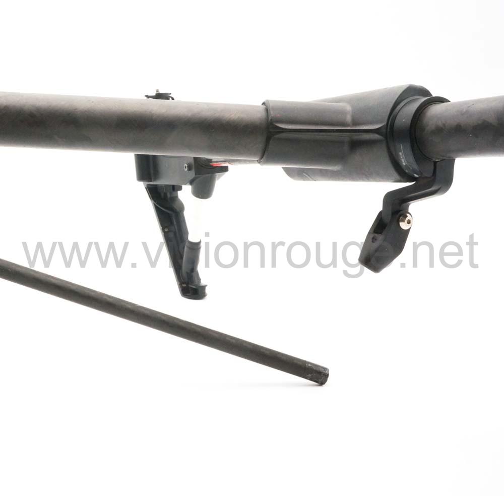

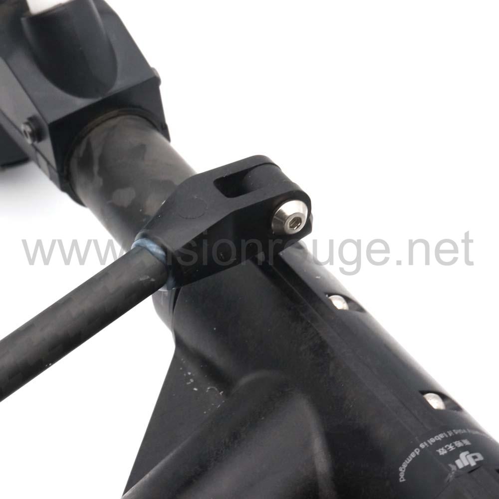

Hardware: You drone will be travelling with you and may even end in your backpack. Be very gentle with it and make a case where it will be secure from any external pressure. I unfortunately discovered that one of the legs was not firmly connected just arriving from a 4 hours flight in a remote location when the airline may have been dropped my very large flight case.
I had few ways to solve this as it was a remote location without almost nothing
I, later, one glue it back using this 3M double component glue for carbon fiber
Check before flying all the element and make sure nothing is loose. Cancel the flight in doubt and always bring a first air repair kit.

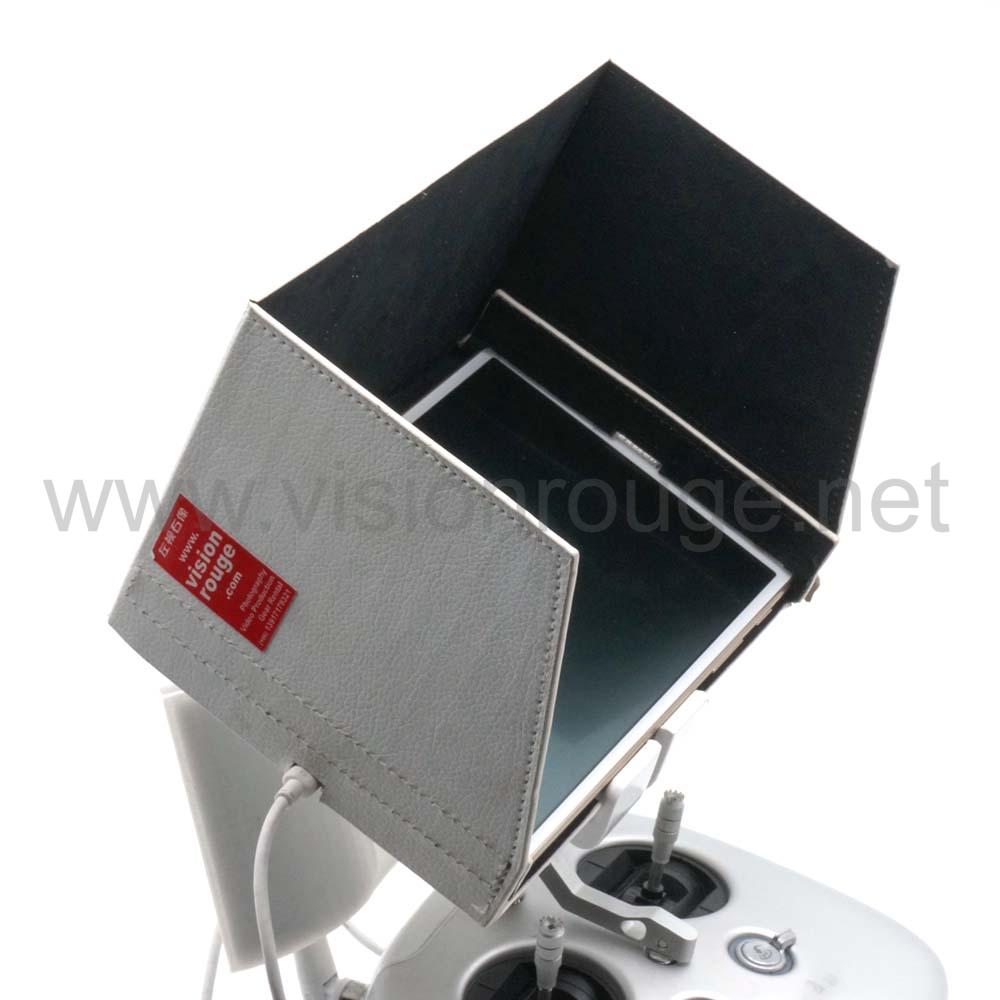

Sun hood for the tablet: The missing part to be able to read your screen outside. I have designed my own as I can’t find anything fitting my Samsung tab S8. It’s foldable, strong and work perfectly to avoid people looking at your screen which can be annoying sometime.
  On your side, be careful to get something which not touch the screen at anytime and press some unwanted function. Test it before you fly.

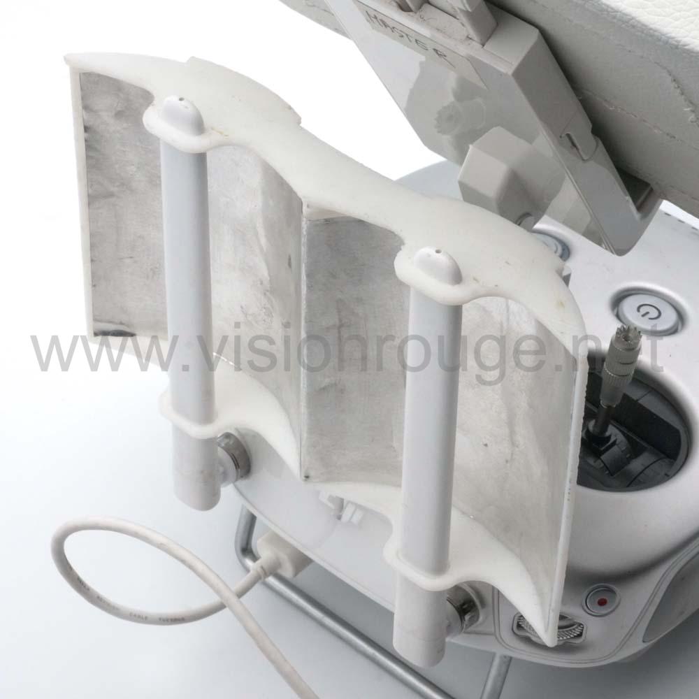

Antenna reflective booster: The DJI remote have 2 antennas, but each of this antenna is actually 2 antennas in one as well, each face is one system, one for 2.4Ghz and one for 5.8Ghz, one for video, one for flight control and instrumentation. I was surprise at first to get only about one 1Km distance before losing the signal. With this 3D printed simple device, it increase to 1Km before losing the preview.
  This is fantastic, it also put the 2 antennas to a very directive and perfectly positioned antenna, getting the best signal available.
  It’s way more directive and you need to have your antenna directed to your bird, but it’s a life saver.

Thank you for sharing your experiences!  I reviewed the information from your link and I really appreciate the candor of your comments.  Be ready for anything....how true.
PS, that looks like an awesome hood!  Is it leather??

Great post.  Where did you get the antenna reflective booster?  I have seen some cheaper versions that mount on each antenna both not one combined unit.

Not leather, fake leather. It's a cheap one for apple product, so I have to cut it to fit my tablet.
Sure you can find some similar on ebay. I bought it in China as I'm living here.

here is the link where I bought it in China
http://world.taobao.com/item/521 ... p;abbucket=8#detail
You may found the same on ebay easly. The cost is ridiculous compare to the range it adds!
