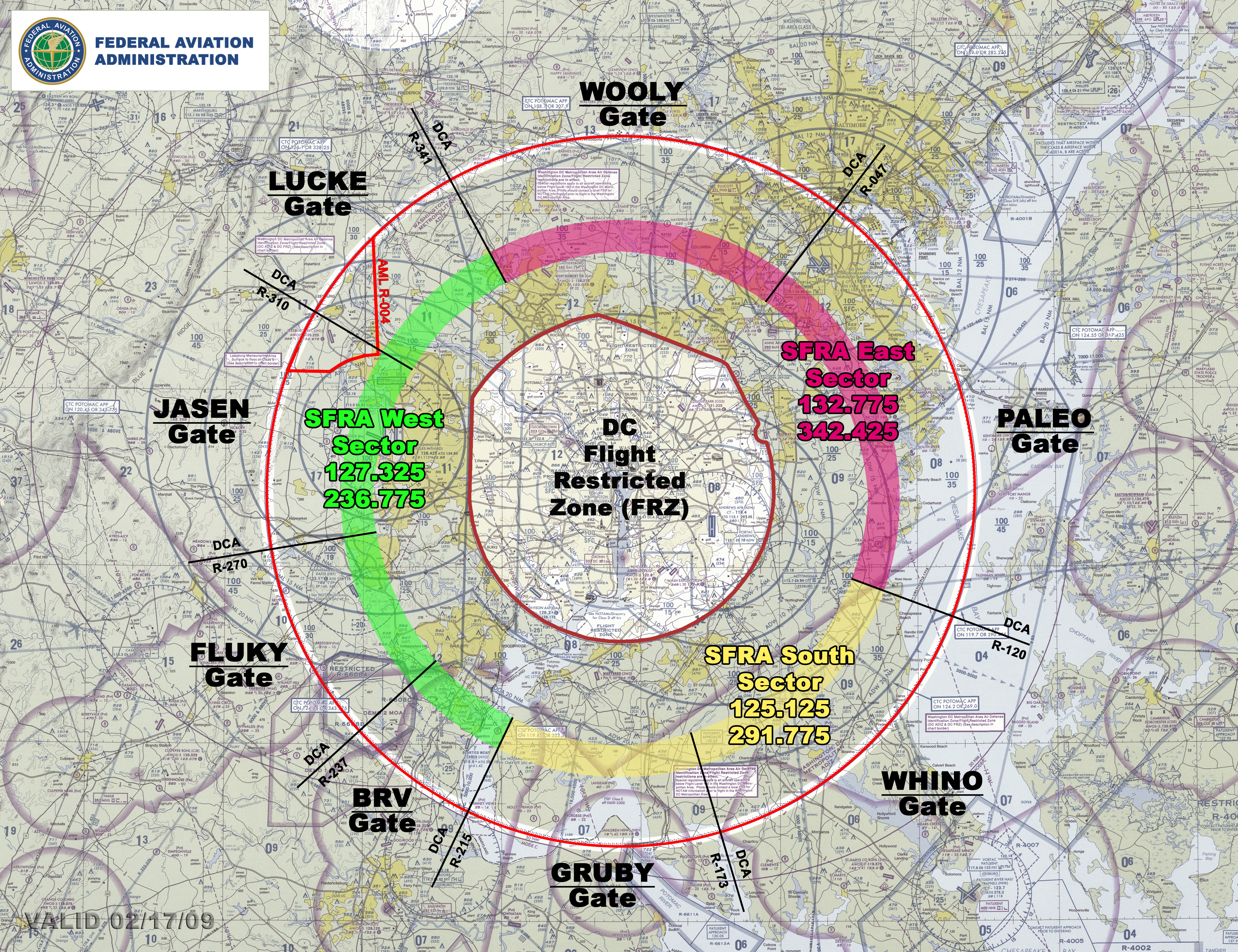

The FAA has reduced the no-fly zone around Washington DC.  What I want to know is how do we get DJI to make this change?  I live just on the 30 mile edge, and now that it is 15 miles, I can fly, but my DJI drone still thinks it has a no-fly zone in my property.
WASHINGTON (AP) - Drones and model aircraft can return to the skies in the outer ring of special airspace around the nation's capital.
The Federal Aviation Administration announced an update Tuesday that shrinks the no-drone zone from a ring with a 30-mile radius around Ronald Reagan Washington National Airport to one with a 15-mile radius. The new rules will take effect Wednesday.
Within the larger special flight rules area, which includes much of southern and central Maryland and northern Virginia, registered and marked aircraft under 55 pounds can fly in clear conditions. They must stay below 400 feet, within sight and avoid other aircraft.
Hobbyists must notify any airport within 5 miles and commercial operators must notify the FAA.

I'm near Olney.  I'm within the DC SFRA and I've been flying my Phantom for 18 months.
There is no flying in the Bethesda/Rockville area.  It's part of the DC FRZ.  There are no exemptions, no authorizations, and no exceptions.  You need to get a little further away from DC.  See this map:  .  Be wary of the Montgomery Airpark Airport in Gaithersburg.
In addition, there was a temporary TFR of the entire DC SFRA due to the inauguration.  It was on and off for three days and it ended at 1230 EST Saturday.
However, DJI has a knack for starting these so-called NFZs several days before and after any temporary TFR.  So that may be the problem.  Hopefully in another day or two DJI will get around to lifting the no fly zone.  Once that happens, you should be able to fly within the outer ring of the DC SFRA without any complications.

What do you mean NFZ?  If you're referring to the FRZ with the 15 mile radius that surrounds DC, it's out of the question.  It's a no drone zone.  Flying drones in there is completely illegal.  No exceptions.
