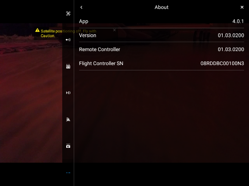

Hi I have bought my Mavic 1 month ago and doing some tests before taking it with me to my next trip abroad, I have noticed an important issue on the gimbal that it seems the gimbal not always doing its job properly. Raising the drone up in the sky it is stable and no matter the speed i cannot see any shake or vibration on the video. Unfortunately,  most of the times during the way down, it shakes and the shooting looks quite unsteady. Does my unit need to be repaired or just need some upgrades? I have reinitiate and recalibrate it and I guees i have the latest release of firmware since the app doesn't  ask for any update. I attach a short video with some unsteady shots where you can see the image is not always very stable when the drone is descending. Pls check this link https://youtu.be/Vmma4Tq6KLK
