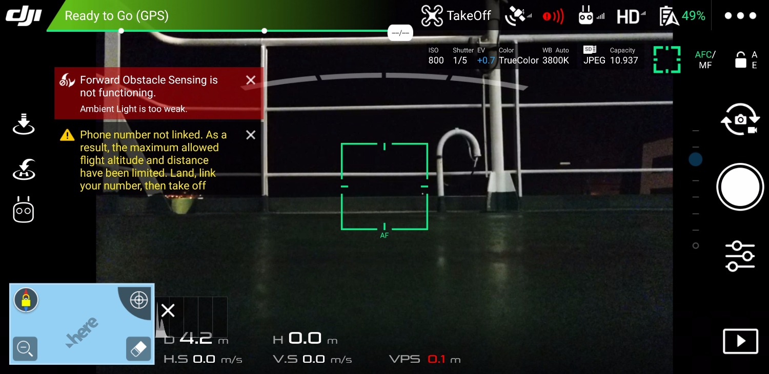

Hello.
I got the same problem Today. Few days ago all was fine. Today i wanted to update my firmware by dj assistant. after update that annoying pop up appeared and ruined everything.
It's strange that why still no solution for such problem and from many people...
I spend 2.5 hours on online chat with dji Assistant. No result. We almost delete installed everything, settings and so on.. but nothing.
I bought my Drone from USA, First flight at my residence Turkey. As i'm sailor now i'm at Indonesia. And that where had happened.
For further check se follow.. hope can have solution soon as now im not able to use my drone
Place of Occurance: Cigading / Indonesia
Mavic pro serial number: 08QCE67012110Z
IP adress of mobile : 10.0.26.28
Verphone log as follow..
2017-11-17 11:50:19:364 E:
**********init**********
2017-11-17 11:50:19:374 E: get ac event ac=İD str=MCC
2017-11-17 11:50:21:687 E: parseResult result={"status":0,"msg":"Successed","result":{}}
2017-11-17 11:50:21:691 E: success getPhoneHistory

Jan'sMavic Posted at 2017-11-17 13:28
Hello.
Please tell me the details of the message from your app. Any other error with your Mavic? What is the current firmware of your drone? The log will be forwarded to our engineers for check. Thanks for your support.
2017-11-17
Use props
Jan'sMavic
New
France
Offline
DJI Elektra Posted at 2017-11-17 18:13
Please see the screenshot from the app.
So far i only have some calibration errors as i'm on big steel vessel with lots of antennas and steel. I have questions to ask but need to figure out this one first because this can not avoid or quit this prompt so i can not use my drone at the moment
Thanks in advance

Jan'sMavic Posted at 2017-11-17 19:56
[view_image]
Please open the mobile data of your phone and update the location. You can let your drone turn on in an open area with good GPS signal.
2017-11-18
Use props
Jan'sMavic
New
Indonesia
Offline
DJI Elektra Posted at 2017-11-18 01:33
Hello again and Hello everyone!
I want to share my flight experience today regarding mobile number registry prompt.
I did exactly you said Dji Elektra but it was useless. Than i decided to play with app and the drone.
Mobile data was on turn on remote, than craft and app opened and prompt appeared immediately.
Same happened while mobıle data was off.
Than i totaly closed the app. and started my engines without any app mobile data was on. Than i started the app and there were NO PROMPT at all!! than i made a short flight and landed. Just right after i stop engines prompt appeared..
I tried again start flying app but it was failure as i described in the first try. Than try the same second attempt opening app after starting engines i was able to use the drone and prompt appeared after landing and engines stopped.
During flight i got the normal notification on the left again regarding registiring mobile number issue but it was just notification but it was mentioned that my flight altitude and distance were restricted this time. i couldnt flew more than 50mtrs away.
I again send the verPhone data for your investigation.
Maybe problem with the app only? but not the craft?
Find the related screenshot below regarding notification..
Thanks in advance.
Can..

Jan'sMavic Posted at 2017-11-18 06:54
Hi, according to the screenshot, the satellites and GPS signal is a bit weak, please try to move the drone in a place with fine GPS signal, restart the drone, link to a local network, then try to reinstall the app again.
2017-11-18
Use props
Jan'sMavic
New
Indonesia
Offline
DJI Thor Posted at 2017-11-18 19:11
Hi.
I've done what you have mentioned and more together with DJi assistant with online chat and we tried abt almost 2 hours. Due to battery consumption and weekend we postponed try. There was no success. We did it with full GPS signal.
Anyway i did what you advised but still no change.
The idea of the screenshot was to show the notification only about the mobile number  registry and restriction about flight altitude and distance because of registry problem.
Thank you..
