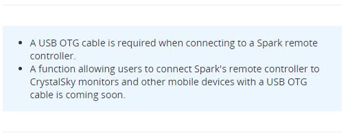

DJI have stated on many occasions in posts on here that OTG is untested. Its undocumented probably because its not something they are working on just yet (I'm sure they are working on other things *25fps cough cough*). Sure it might work but because its untested, anything that happens is on you.

I dont disagree with you on the untested/unsupported point but they are also very aware that until now, they have not blocked it's functionality.
Considering that it's not a cheap toy, I think I would have appreciated a footnote on the release details at least acknowledging (out of respect for their customers)...along the lines of
*** We are aware that some users might be using an OTG cable.  As this is not something that we have tested, or can support, we have now removed this capability ***
