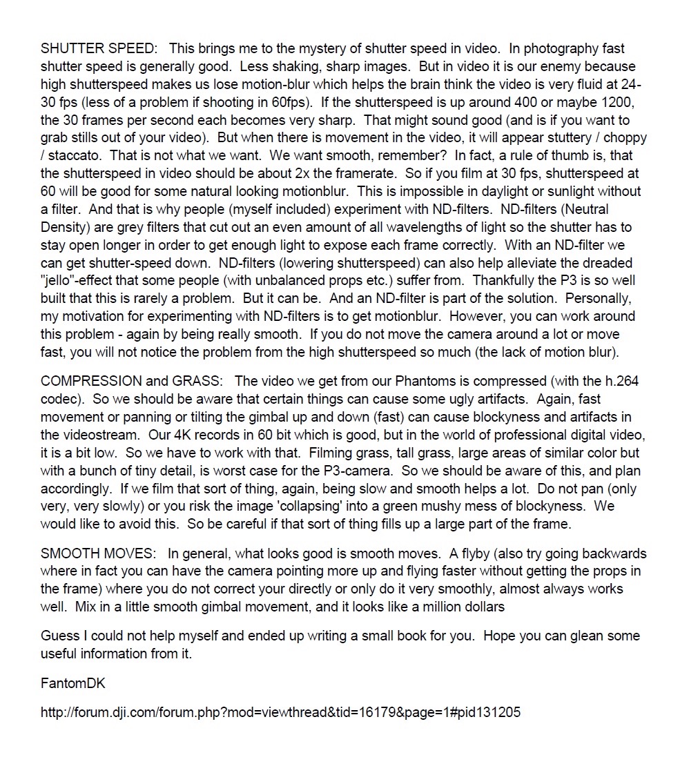

Here are some tips I took from another thread, if you search you will be able to find the original thread, but be aware I could never get my P3S as smooth as I wanted

AlanHd Posted at 2017-11-22 05:47
[view_image]
Please follow the advice above and try again. Hope it can solve your problem.
[view_image]
Thanks for the tips
